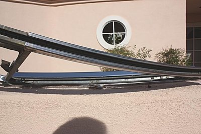

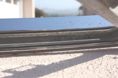

Photos...
Here are a couple of pics of the vent window and the rivets..
I think I understand how the removal & re-attachment work..
If I am correct, the rivet with the cross mark is the current attaching point and the nice round one is ready for the next evolution.
The right frame appears to have both rivets punched on the upper attachment point. Will this be an issue?

Just like Prop says , extra sets to re-attach with . I set mine up in my vise to reassemble, used good soft towel backup and a small bolt as the drive pin. Modified some attachments to my ball joint press, and used it to press rivets down. I think youll be ok with 2 out of 3 rivets on the one side.

I agree, should work fine.......and honestly what choice do you have if one set is already pressed? It's pot metal, well all know how great of a material that is to work with. Forget welding or soldering anything to it.
