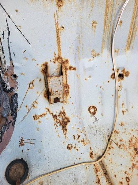

Here's a picture of a 66 . They go straight into the back.
Where they go through the floorpan There is a large plate with a nut welded to it so they won't tear through the sheetmetal
