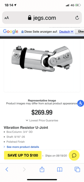

Hi all, now I need again a recommend from you guys, Because Ihave the choice between Borgeson and Flaming River.
what you prefer :Borgeson or Flaming River ?
Some one use kind of this vibration reducer / damper and have experience with it?
My set up now is :
Flaming River rack and pinion DR502-5
With two universal joints one on the Original shortened column , and one at the rack and pinion. , between are a double D -Shaft and a support bearing, what normally only recommend by more than 2 joints in the steering , but anyway I have one, because my control freak suspension First Generation had one bracket for the support on the frame already welded .
Picture 3 is flaming river
Picture 1 is Borgeson
Picture 2 is actual version without any vibration damper all flaming river with two „Standart „ u- joints in the steering.
One thing I do know about Borgeson part is the isolator also isolates the ground through your steering column which in turn makes it so your horn won't work, Ask me how I know! Not sure flaming river is the same. If you use either of these I would check for continuity across the the joint and as Borgeson recommended run a jumper wire across before installation.
