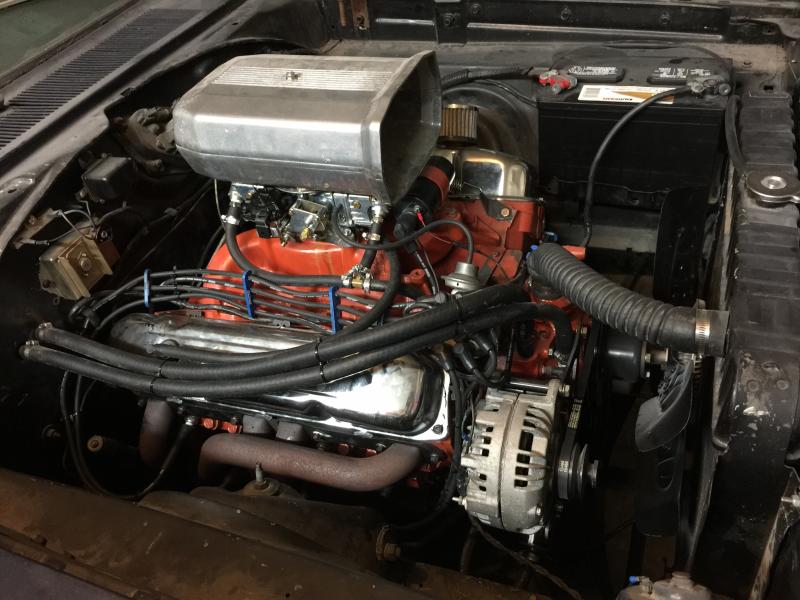

I thought that after a few revs it started to sound like something was not right. Yet nothing was mentioned by him after exiting the car. I bet dollars to doughnuts that it ain't right...Just My 2 Cents...cr8crshr/Tuck
I remember being that age and my dad and uncles firing up mopars......Ill never forget it!
Alright, what are you saying isn't sounding right. I know it isn't perfect. I haven't tuned the carb or even set the timing. I installed a new cam and had to keep the rpm's up so I can keep the cam lubricated during break in. My goal was to get it started and break in the cam. But due to oil leaks and fuel leaks I couldn't run it long enough.

I don't know how I missed this the first time round? Sounds mucho better than before, what was the knocking and what all you do fix wise from a few months ago?
Thank you. The fan was hitting the bottom of the radiator by a hair. I just added a couple washers between the fan and the factory style fan clutch to space it back. I also had to replace the carburetor. I just installed the new one (770 street avenger). It's still not perfect, but I have to get some good gas in it and vacuum tube the carb.
