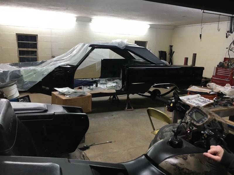

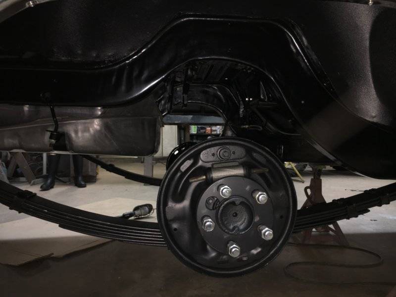

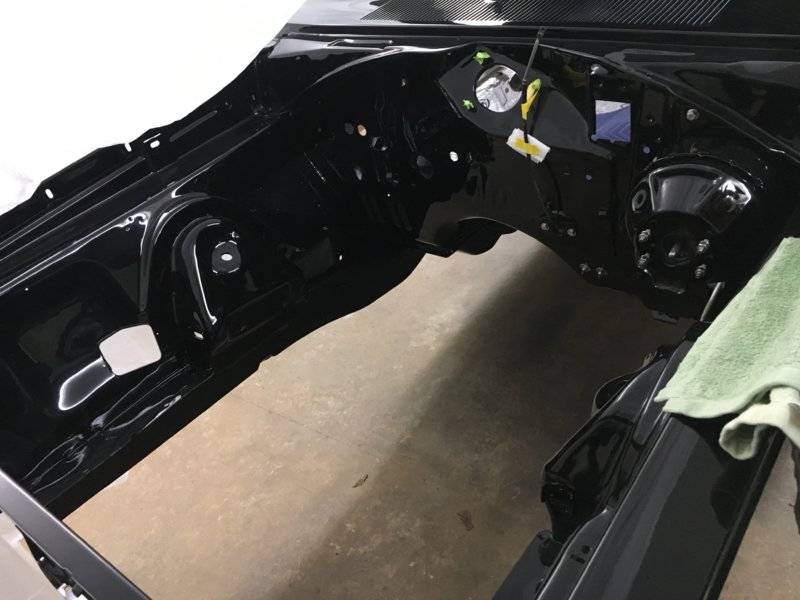

Does anyone know if it’s possible to put a.c on a 426 Hemi with a factory 2 4barrel intake? I’m restoring a 67 Plymouth gtx that will have a 426 and a 4 speed. The car is black on black so I’m thinking if it’s possible to put ac on the car that I’d like to. If anyone has any experience with this Aby information you can give me would be much appreciated.

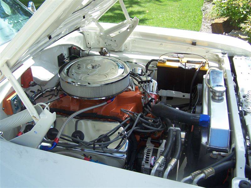

Yes, can be done. Local here in Phoenix, Don Petty (Richards cousin) has a 69 hemI Road Runner with aftermarket AC
CVF serpentine kit would work, bolts to water pump housing, nothing else

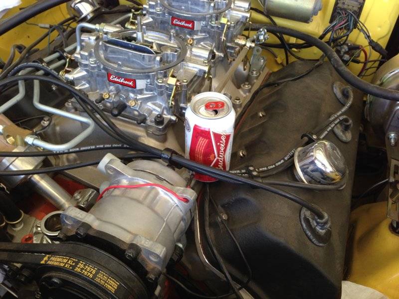

I installed air on the old wagon. It had manual steering, so I used a low-mount setup.
