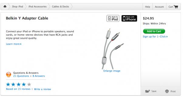

I put an amp under my package tray and hooked it up to two 6 x 9 speakers, also mounted to the package tray. I ran an rca cable from the amp to the front seat. The cable is an RCA on one end and a headphone plug on the other. With the amp, the speakers and the cable, I plug my iPhone into the headphone end. This gives me my whole library of music in the car.
It also leaves the factory AM unit in the dash with the 4 x 10 speaker so I can listen to the Milwaukee Brewers.
A two channel or four channel amp works fine. A four channel is also handy if you want to add speakers up front some day.
It takes an afternoon to install and is pretty cheap if you can can find a decent amp on ebay or something. The only thing that you can see from the whole system is the headphone plug up front where the iPhone or iPod or whatever plugs in. The rest is pretty well hidden.
Almost forgot, I added a switch that is under the dash. It controls the remote wire for the switch. So, if I do not want the amp on when the car is running, I can switch the amp off.
That is what I did.
The wire I used:
