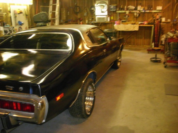

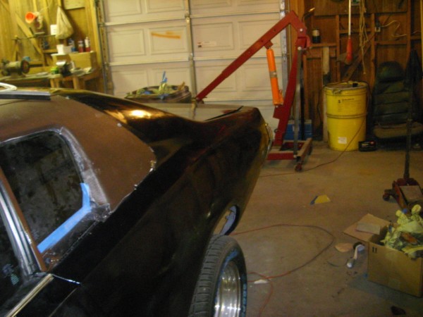

SEM is the best money can buy. Ever try to get a Cordovan brown top for a 73 Charger or anything but black and white? My Cordovan brown top was black and a fried gave me enough gold leather to make my Light tan and Cordovan brown seat covers.
