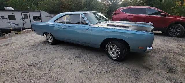

I have a 69 Road Runner hardtop in B3 ice blue metallic.
I'm debating on having a vinyl top installed as I really like the look of them....plus I find my RR in B3 is probably the least "muscle-y" color. I reaĺly like the look of a vinyl top
Are there any pros and cons to the vinyl top?
I'd have have a classic car body shop do the install.
Thoughts?

You'd also need a set of vinyl top drip rail trim, as it's wider to fit the top material. Rear deck trim pieces, holes drilled in the C pillar.

Your car is beautiful the way it is. As said above, you will have to find the trim that's required for the vinyl top and put holes in that beautiful car. I agree, please don't. But it's your car and I would still like it either way.
Yep, love and hate with vinyl tops. Had a few and MO, never liked them; but they were the thing back when. They were finicky to keep looking nice. As posted, yours looks sweet just the way it is; but of course, it is YOUR car and YOUR choice.
Water getting trapped under the vinyl (rust) is a potential issue. I guess it'd be ok if you keep it stored indoors. I saw some bubbling on the c pillar vinyl of my 69. Sliced open the vinyl and sure enough, rust. Now the vinyl has to come off and rust repaired. No more vinyl for me even though i like the look.

I'll never have another one. I have had rust issues under several of them. All it takes is one tiny spec of rust to grow into a problem. I actually removed the vinyl top from my current '67 and painted the roof.
If someone does decide to install a vinyl top today. It will out live us and probably will not create any rust issues. These cars are no longer daily driven in all weather conditions. Most probably stay in the garage more than they are driven.
Restoring my 69 Dart. It originally had a vinyl top. It wasn't there when I bought it. Just covered the holes from the trim and left it off.

Exactly. And the roof will likely be sealed up as compared to the 1/2 finished roof from factory.

Thank you, I like it.....not perfect but a stepping stone to an A-12 or a '70 someday.

Now I'm on the fence about doing it. (Actually leaning more to not doing it now)..some of the replies have made me think twice (which is good getting other perepectives) so for now I guess I'll wait until I'm 100% sure either way but maybe doing something else less "permanent" might be a better solution.
