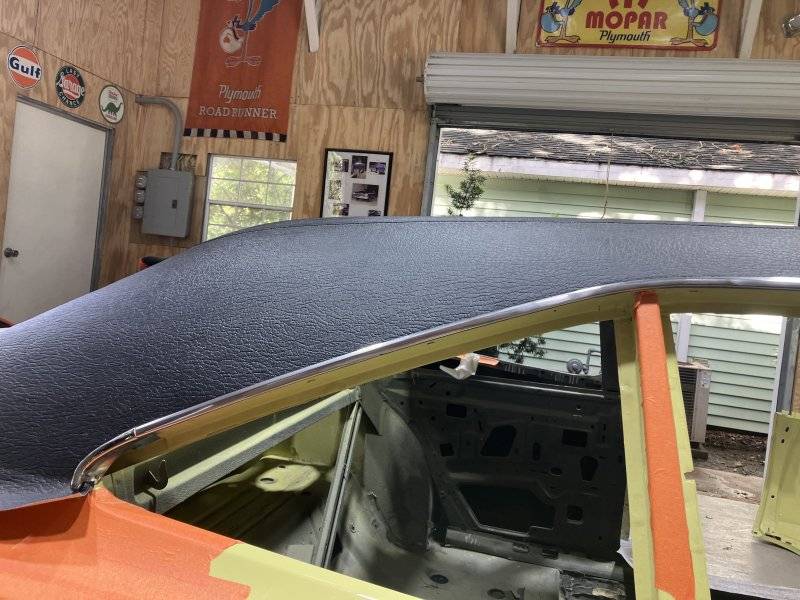

I just recently did my vinyl top on the Road Runner.I did notice that there was a staple in each corner of the window frame. I did not reinstall them ,I just glued them down
