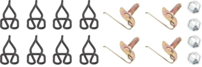

Hi guys, the clips for the trim that goes from the very end of the roof down by the trunk along the side to the quaterwindow on a Charger, those clips and clips with threads on wich order are they mounted on the trim?
The cap nuts are accessible in the trunk and as you move towards the front the spring clips hold the trim....
Thanks dude! =) Do you know if you can find clips for the trim up on the doors?
The question is do you want reproduction or original?........I can direct you to the right person depending on your choice.....
Uhm, whats the difference? i mean its just clips right? =O
Wish it was that simple.....The reproductions function well to hold the trim but they lack the proper cushioning pad and the last clip/nut by the door jamb is completely different. So if correctness is not an issue the reproductions will hold the trim properly.
Okey, what does it cost? I still have the door jamb clips/nut so thats not a problem, just need the the rest of the clips =P Maybe i can make som better cushions for them.
