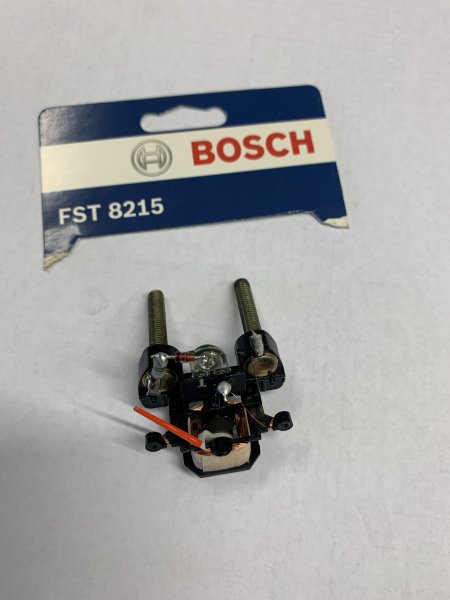

I have done a couple of them. As Toolman said its a matter of finding the right size gauge and sweep that you need. It can take some fitting to get it sitting just right but it's usually worth it.
The last one I did recently.
I used a Bosch 8215 I got at a local auto parts store worked great
Heres the gauge after being removed from the can- easy to attach your own face plate to it
