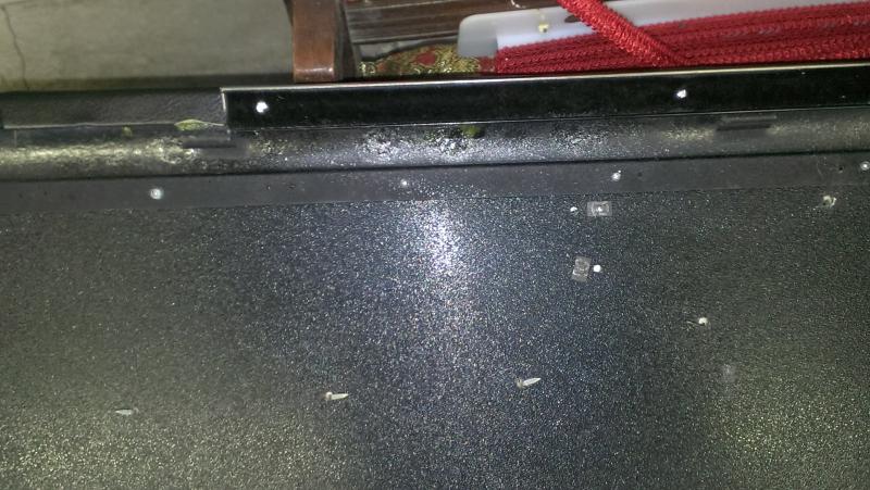

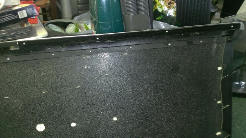

I used my old cardboard ones for a template and bought a sheet of abs plastic and made my own,turned out great and won't deteriorate..
Jeff how did you fit the plastic over the curve on the top of the door.
What fasteners did you use to attach the plastic to the door.
Thanks
You really need the metal pieces (attach to top of door curve) ....I think Jeff is saying he used abs for the backing board ONLY?
You will need to find these metal strips as the backing boards and also the whiskers (fuzzies) are attached to them .ABS won't work here!
IMAG0669.jpgIMAG0670.jpgIMAG0671.jpg1962 polara is right, you need the steel pieces to connect the abs plastic to.

Wow that looks great Jeff. I'll keep that in mind for my 65 if I need to replace the panels.
