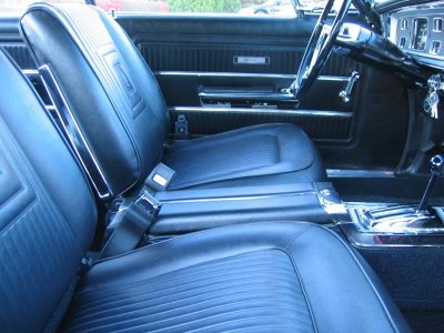

These are extremely rare in decent shape. I did the following for mine in my 65 Satellite: I removed the chrome piece from the top (must be slightly modified later)--cut a piece of thick foam padding to fit the recess at the back. I carefully measured the top as it cascades down the rear and side surfaces (as seperate panels) and cut these out of white cotton material (similar to a bed sheet). I test-fitted these until the configuration was taught, marked where stitching should be, transferred these markings to a piece of black vinyl (bought at a fabric store) with an extra 1/2 inch on each edge. I then hand-stitched the panels inside-out which when finished, formed a pocket covering that fit very nicely over the foam. At this point, the chrome cannot be reinstalled without removing the tip that curves into the recess. I ground that off using my bench grinder--carefully dabbed clear urethane on the ground tip so it wouldn't rust--reinstalled it and it looks GREAT! A neat little winter project that took me 3 nights after work, but a real nice outcome. I also covered my console door (much easier task)--I'm sorrry I don't have a pic of the end piece.
