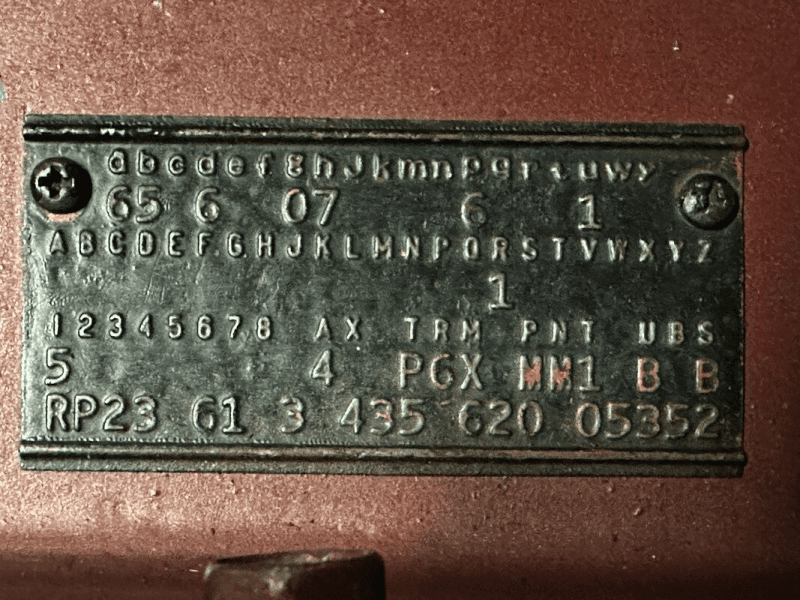

Was a 383-2 and 4 speed available in 67?
YY1
10:45 PM
Jun 26, 2010
29,661
28,433
FL
I thought it wasn't.
is this tag legit?
From what I've read:
In 1966 they offered the 361 - 2bbl in b-bodies
In 1967 they offered the 383 - 2bbl in b-bodies (and a 4 - barrell as well)
Likely very few still have the original engine with the 2 bbl and the original transmission.

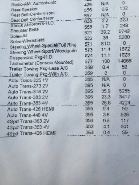

Four speed was NOT available with a 318 in a B body in 67.
I cold have sworn we just had a thread/post about a 67 Dodge, where a very knowledgeable member said 383-2 and four speed wasn't available in 67.
As 69Coronetrt kindly posted, yes.
Here's the #s for 67 Chargers
