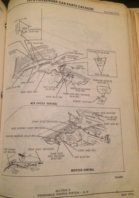

Im confused on the correct part numbers for the washer reservoir assembly. It lists 3431691 w/o speed control and 3431965 w/speed control. Is the speed control in reference to the wipers/motor or cruise control? I've seen it stated as cruise... What does the washer have to do with cruise control?
Im also curious as to why my washer tank doesn't have either number on it. Mine says 3431670... Is that an older number that was superseded?

makes reference to the cruise control. Cruise control cars gets the washer reservoir on inner passenger side while non cruise controls got them on driver side.
Talking about PNs, the catalog PNs are not allways the same ones casted on parts. Catalog PNs used to be called SERVICE PART NUMBERS since they offer a full assembly PN

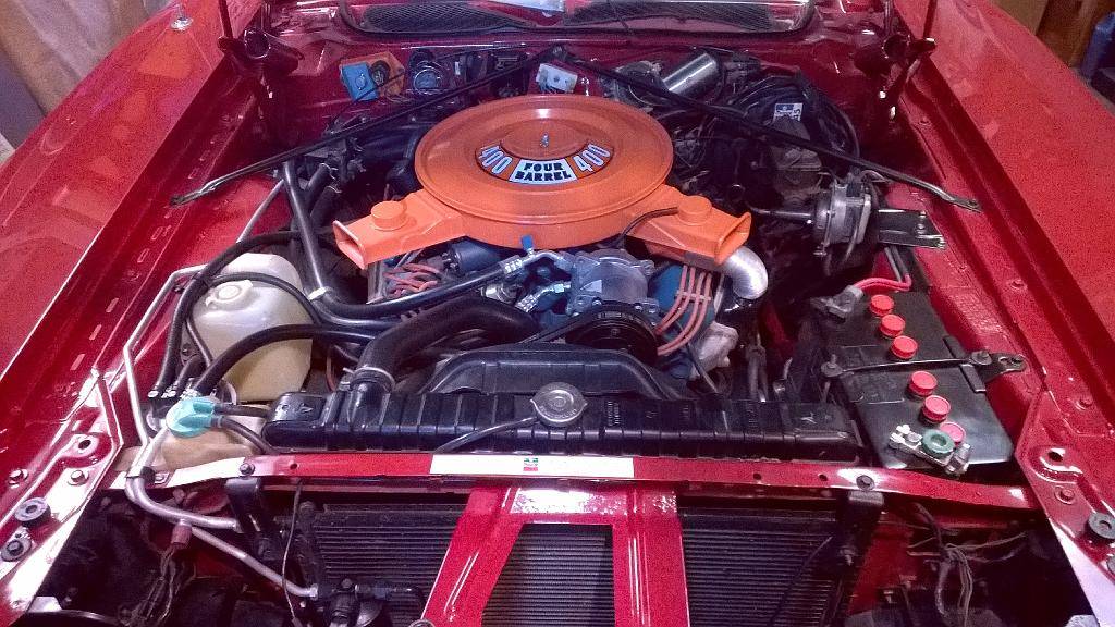

When cruise is installed, it goes where the reservoir would normally sit. That being the case Chysler put the res on the other side. Mine has cruise and the other bottle.
You can see the bottle on passenger side.
