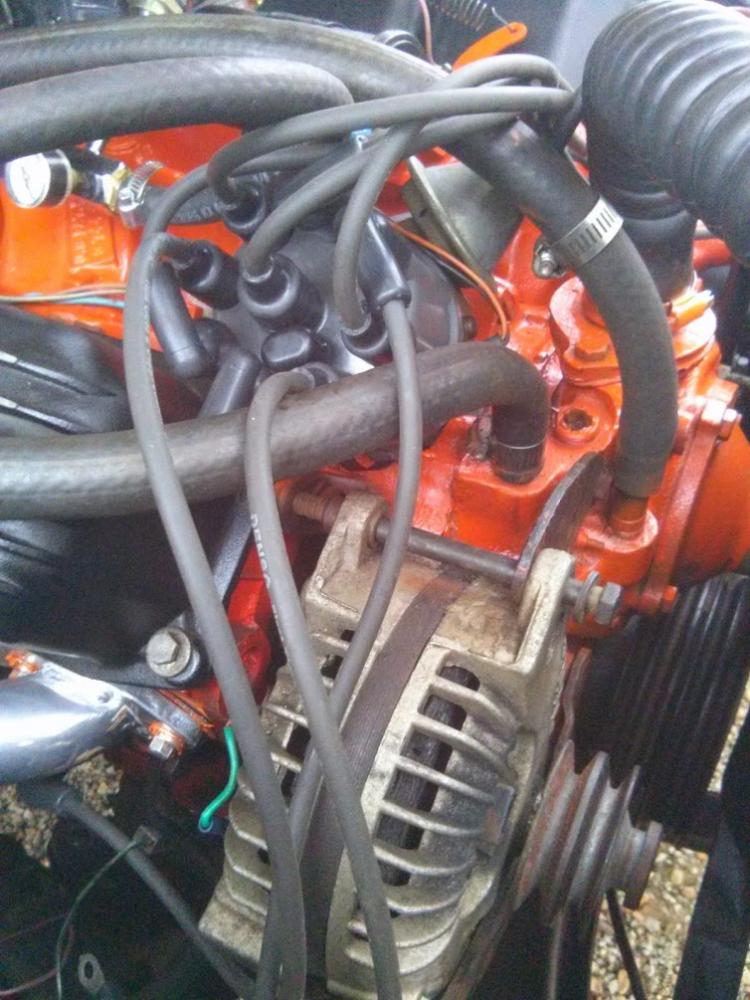

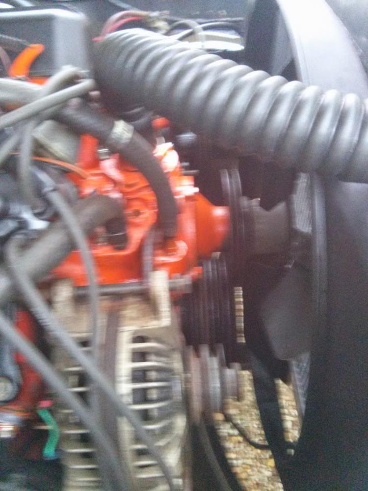

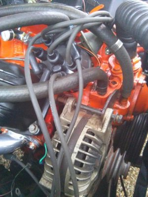

I have a 1969 Dodge Coronet originally a 318 car but has a 383HP B block I believe in the car now. I think this new engine was from an AC car but not exactly certain. I have swapped out the Power-steering bracket with a proper fitting bracket (they other looked to have been put on by MacGyver himself). The Crank Pulley has a 3 slot belt setup. The alternator bracket looks partially wrong but it lines up with the crank pulley.
The problem I am having is that the water pump pulley sticks out way too far and cant match up with the alternator. It could match up directly below with the last crank pulley slot but did not want to put a small belt straight down.

I don't really want to replace all the pulleys but this may be the easiest way. I am thinking the water pump pulley is not deep enough or just very wrong.
I am going to attach what pictures I have of it. Sorry for how blurry the one picture is.
The alternator is not on the bracket right I was playing around with it to see how far off it is.

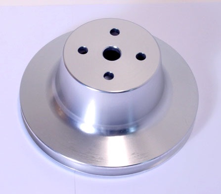

A double groove water pump pulley might fix the problem, or a deeper single
Like this, 440 source has billet and steel
Thanks this is what I was needing to know and will order one today.
