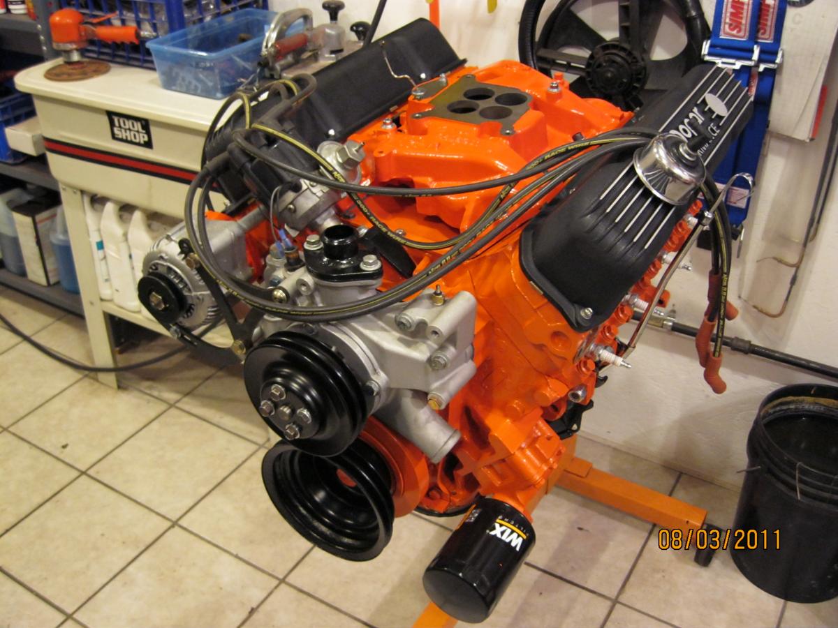

Pic up now. Only look at the water pump pulley, it has to go towards the engine one grove, approx 3/4 inch maybe to align the two groves with the crank pulley, just looking to get the correct pulley with the right backset to run both belts, part number etc. Hope that makes it simpler, thanks. There is plenty of space to set it back farther without rubbing the pump casing.

I think your w/p pulley is for an a/c car and the lower pulley is for a non- a/c car. Your top pulley should look like this:
http://store.440source.com/Water-Pump-Pulley-Non-A_C-New-Reproduction/productinfo/132-1002/
