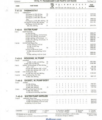

I pulled the radiator and water pump. The pump has 8 fins and the rad has two passes. I am having the rad upgraded to a three pass rad, so know just have to come up with the correct pump. So off to the parts store to look. Here is a page out of the Moper Parts manual.

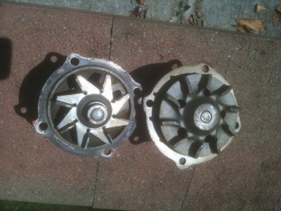

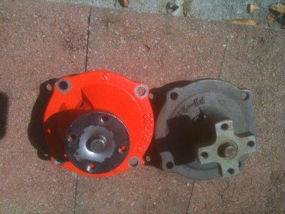

The replacement pump showed up today.......BUT appears to be different in some ways. Here a two phone pictures.

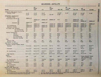

Although partly correct - there were six and eight blade pumps - the six blade pumps were the ones for air conditioned vehicles except for the 426 hemi, which didn't have air conditioning but still used the six blade pump. Standard engines (except sixes) used the eight blade pump. Fan speeds were higher on A/C cars though.
Year to year differences are probably out there but this is what my service manual lists, at least for 1970.

Here is what I have decided..... I am already having the radiator upgraded to a 3 core over a 2 core and reinstall the pump I took out....because it looks and turns just fine. Then if something is still not correct then it's my bad ;)

Just a quick thought, if you look back on that page I posted from the shop manual, take a look at the pulley ratios. The A/C cars had fewer blades BUT ran at a much higher speed. Something else to ponder.
