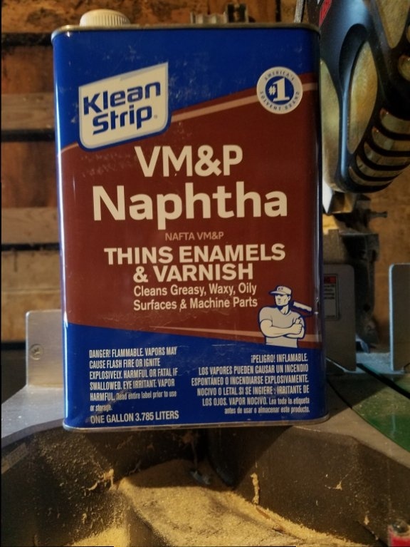

No with the acetone. To harsh! Kiwi suggested lighter fluid. At work we use Naptha, it smells a little bit like lighter fluid. It's another cleaner that's mild enough to remove wax and is used to prep the vehicles before doing spot repair. Windex will work but is amonia based and will streak and there is a good chance you have some already.
