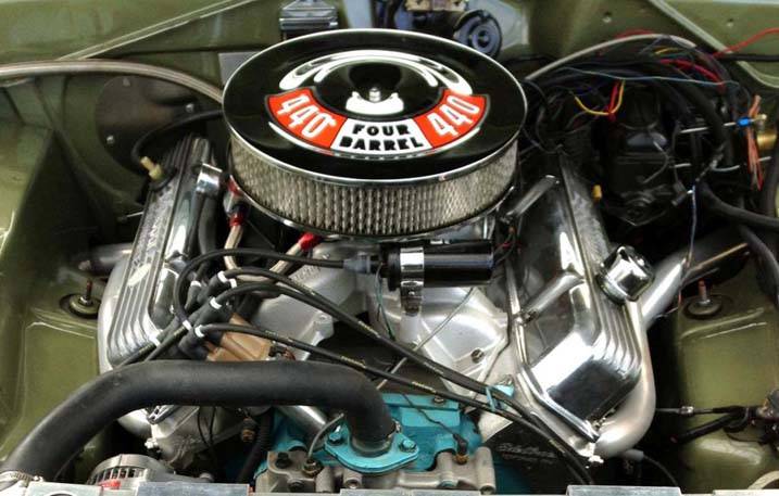

As some are aware, the space between the passenger side exhaust manifold and inner fender is quite tight on a 440 swapped 62 Plymouth. The car keeps popping the plug wire on #6, and it was quite a challenge to get the boot to snap back on. Once I got it, I wanted to check the other boots but couldn't access #4. My question is, will new heads (Performer RPM) and headers (TTI or Doug's) give me and my big dumb mitts more access to the plugs?

Sometimes it’s easier to get the plugs from under the car. Or reach from the front and go under the manifold to get 2,4 and 6
also, get some quality plug wires that don’t fall off.
Buy short spark plugs. They are hard to get, but are available. My father-in-law just had me install some in a Chevy 350 based car with headers that had clearance issues (in this case with the headers, believe it or not).

Street cruiser as I don't have the balls to do more than that in a convertible. Overall power plans are heads, headers, intake manifold, carb, thumper grind cam, & exhaust. Good to know about the 1 5/8" headers, thanks!

Have you made sure no part of the plug wires are touching any part of the exhaust? I had an issue a while back with a plug wire popping off. It turned out to be the wire was barely touching the header pipe causing the wire to heat up and allow the wire to pop off the spark plug. It took me a long time to figure it out.

That's typically what I do, going under the alternator with my right hand, then "taking the left turn towards Albuquerque"...
it's then a matter of getting hand, wrist, forearm all slithered under and back to get the plugs under the headers.
With me, that means I gotta elevate myself a little and belly up on the fender so I can bend over enough.
Next time? I'm trying from underneath - and I own hole saws. :)
