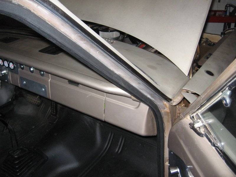

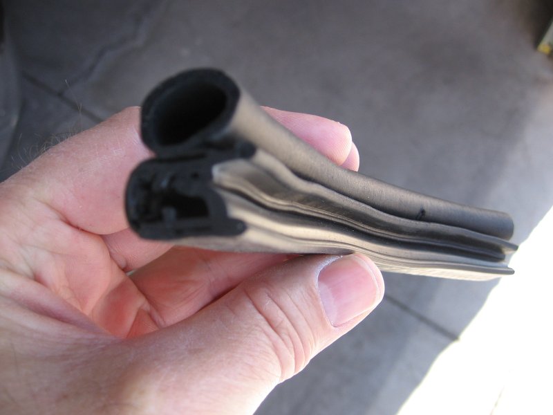

Unless you want 100% original there are thing you can do. I know nothing about the 70's cars but is the weatherstrip around the door or on the body? Window sweeps can be bought without clips, cut to length and then drilled and screwed on. The screws go deep into the fuzzys and never contact the glass. I did that on my 63 4 door.
IF the door seals are on the pinch weld of the body,I bought door seals for a 88 Dodge Ram pickup. 2 sets were less than $40 at rock auto and will do all 4 doors. I did 3 of my cars a 64 Dart a 68 Valiant and a 63 Belvedere

The door to body seals are on the door on these. They use the “windlace” on the body side at the pinch weld, which is reproduced. I was thinking about some of the generic stick on weatherstrip for the doors, cut and glued at a 45 degree where the top corners of the door make a sharp bend.
