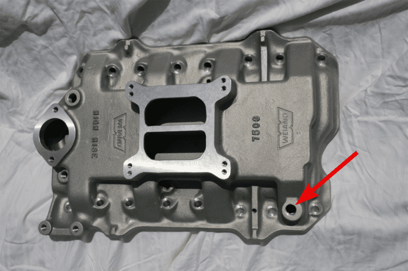

For those of you who have used this manifold, I'm interested in what the rear port shown was provided for.

No photo, but I'm guessing you're referring to the threaded port on the back, which is a vacuum port for the brake booster. just plug it if not needed.

Strange that my picture file dropped from the post. I just reattached it. Yes that's the port. I already had it blocked but was just interested in what the provision was for. Actually, my manifold has all indications it's a one of the first castings or possibly an even earlier prototype in that it had / has none of the production markings cast-in. It is simply stamped "7503" on the bottom of the manifold. The casting quality is also not quite up to the same finish level as the production castings with cast-in graphics. It was in such rough shape that it was perfect for modifying into the supercharger manifold it is now.

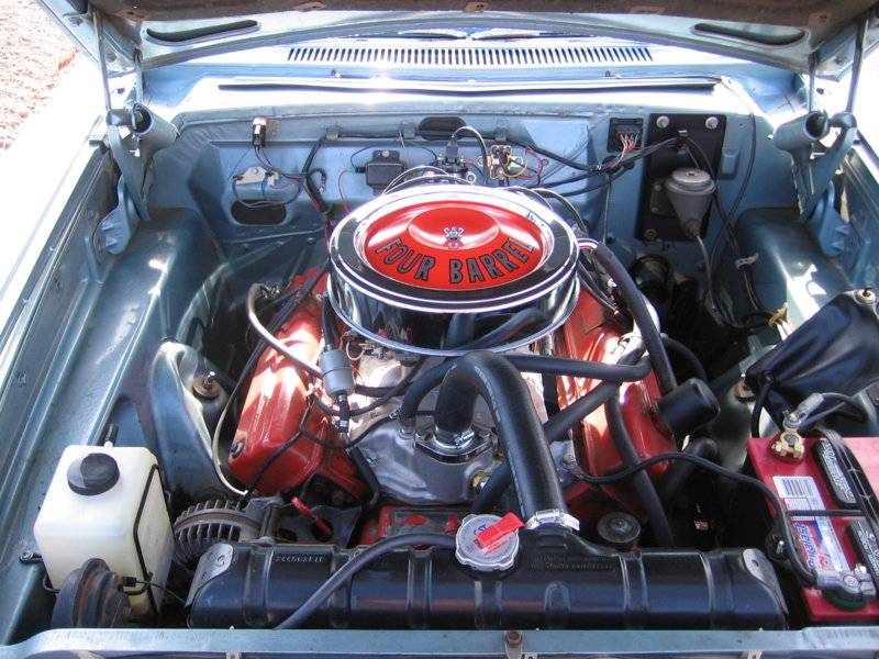

Best thing I ever did to my Poly. Intake,carb and dual exhaust.

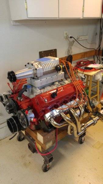

This is mine before I swapped out the P600 manifold shown to the 7503 Weiand in order to reduce the overall height. Shown on the P600 is a 3-deuce to single-4plenum I made to allow the Magnuson to be added but also to create space for an intercooler if needed. The same plenum allows a single-4 barrel (without the supercharger) by changing out the top plate). The engine shown is actually my "test mule" and has 105k miles on it. I have a fresh engine I'll drop in this winter. I'm just buttoning-up things now with the test-mule and have it mated to a new TKO-600 5-speed. The headers are 302-351 Ford stainless steel. This is all in my 65 D100 Utiline.

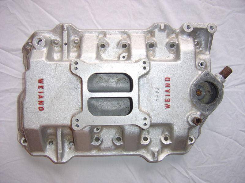

It does look like an early one, but I don't think it's a 'first run'... I have seen a few older ones, and yours isn't too far off from what mine was, which was purchased from Summit a decade or so ago. The really early ones didn't have the "W" outline.. they were like the one below:

The manifold shown is not mine but is simply a picture I borrowed from the internet. Mine doesn't even have the Weiand script or the 7503. There was only "7503" hand-stamped into the underside of the manifold. There is nothing on the top surfaces. As well the casting surface finish of mine is / was like none others I've seen. It was very wavy and rough. I also found major casting voids in at least 2 of the mounting holes indicating metal flow was not correct or certainly not yet optimized. Mine does not have the 2 small holes shown in this picture at the 1:00 and 7:00 positions relative to the carburetor flange or the hole in the stiffening rib shown in the upper-left in this picture. The temperature sender hole on mine also looks nothing like the one in this picture.

ah.. okay, I thought you were showing your intake. Yes, sounds like you have one of the very earliest. I had talked to Landy's son for a couple of weeks back in the 1990s trying to get pictures or information about their blower kits. He had given me specs, but couldn't find any pictures or provide contacts. I thought it was pretty cool that his kits were a direct bolt on - perfect for the Poly because they're like 8.8 CR or something like that.

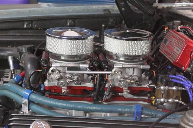

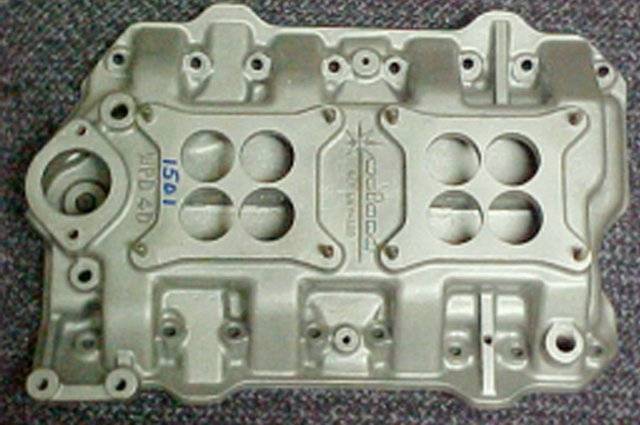

Incidentally, I still have this intake in primo condition. Not sure what I'm going to do with it at this point, but if I can find another car like a 55 Savoy or something, I'd entertain rebuilding the Poly and running my dual quad EFI again.
