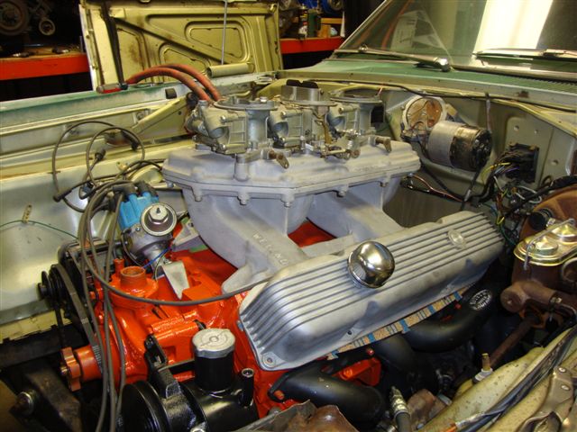

Here is my STR 14-4

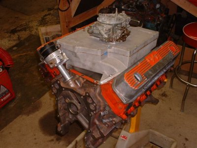

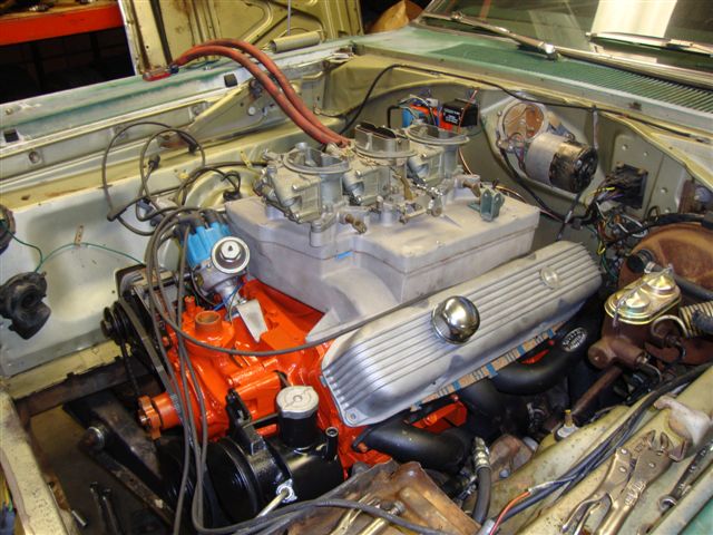

STR with the 6 BBL top and the tall one is the Weiand 6 BBL
Yea that last one is the Weiand type I am looking at getting. Looks as if it would really work well if you get the fuel flow right. Has the runners similar to the max wedge intake. Good ram effect I would think. Guess it was meant for a super stock application, as a legal intake that made real good power.
those long runner intakes can be rough to get set right and are designed for upper rpm range power.can be hard to get to run right on a street car(loose a ton of bottom end torque)but work great on a true race car.
