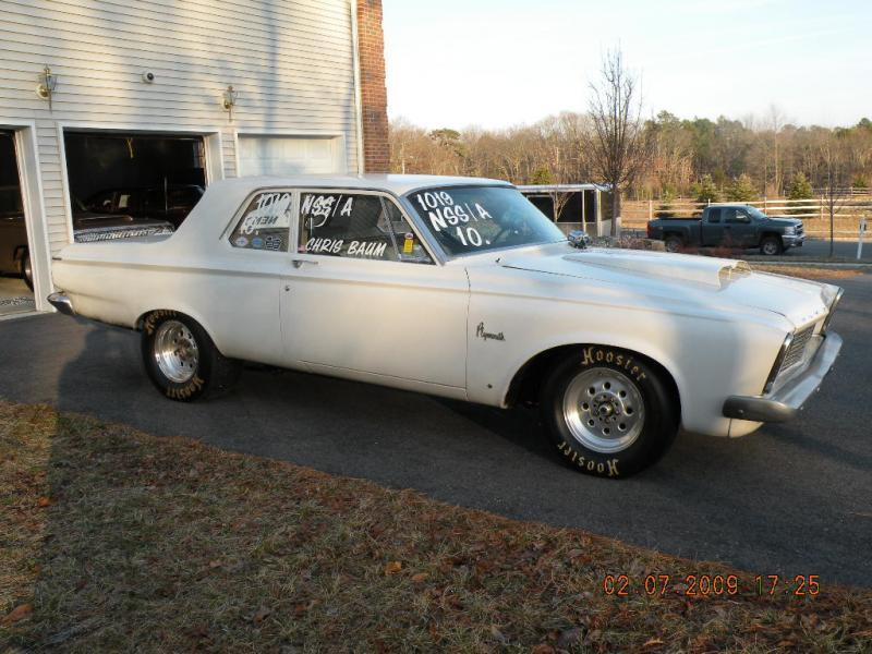

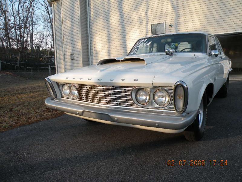

I got a full set that would fit exactly in your car. was in my 63 Plymouth with no mini tubs, stock wheel wells.
15 x 3.5 front
15 x 10 6.5 back spacing rear
heres a few pics
scratch the rear idea on mine then. 15 x 8.5 with 4.5 backspace you can fit a 30x10.00 rear tire

Like that, Dumb question ( not much of a tire guy). So the rims on back are 15x 8.5". And fronts are 15x 3.5". Correct? That's a narrow rim up front

unless your just a street car,then go bigger up front. but most racers use 3.5 fronts.

8.5 rear 4.5 offset
