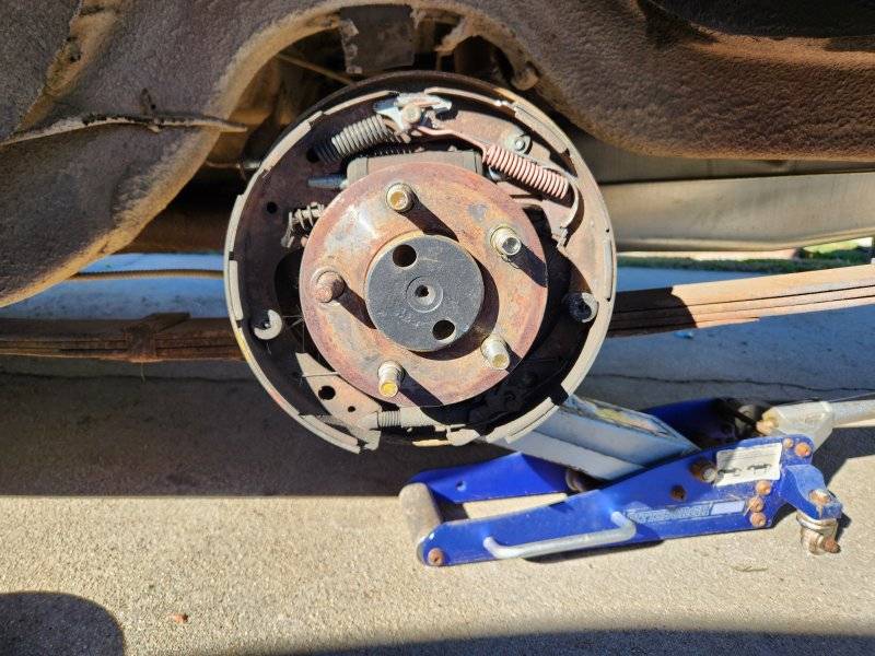

Driver's side seems worn but ok:

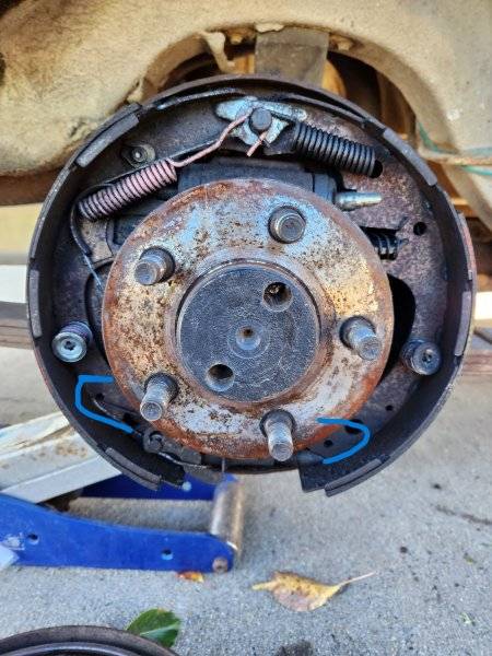

Pass side is another story, definitely was contaminated but not wet and I didn't see an active leak. Possibly the cylinder was changed a long time ago but the rest wasn't cleaned? Also the bottom most spring was broken which I think it the real issue. Is it possible that bottom spring situation is related to the adjuster when backing up and then it takes a few stops to get back in place? I figure its that or the contamination. Pics of the pass side mess:
The axle is blocking the full view of the broken spring so I highlighted what remains of the spring and where the other end likely went in the pic.

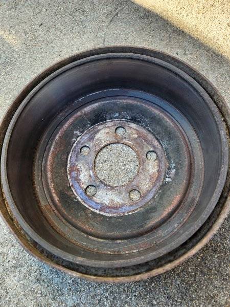

Drum size refers to the inside measurement. If you have approximately 11" measurement on the outside, you've got 10" inch brakes.
That makes a lot of sense, I also compared the broken spring piece I have to some pics and it matches the 10 inch stuff. 11 inch hardware is different. I'll probably still double check because of paranoia.

Yeah I would say that pretty much answers that. While looking at the usual sites they show two different width shoes for the rear 10 inch brakes. Any clues from the pics there?
