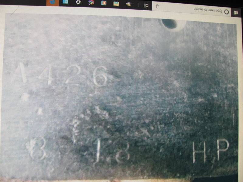

This block came out of a 65 Monoco. The guy that I bought it from pulled it out himself so I know it’s origin.

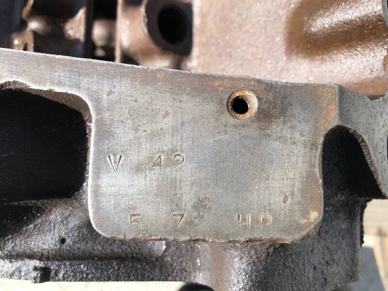

This block is a 64 B-body. I say B-body since the largest engine in a C-body at that time was the 413. 2383FD7A-F864-47E7-9944-68D84C7F8BF8.jpeg

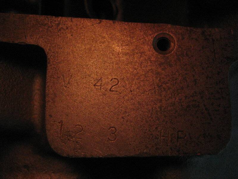

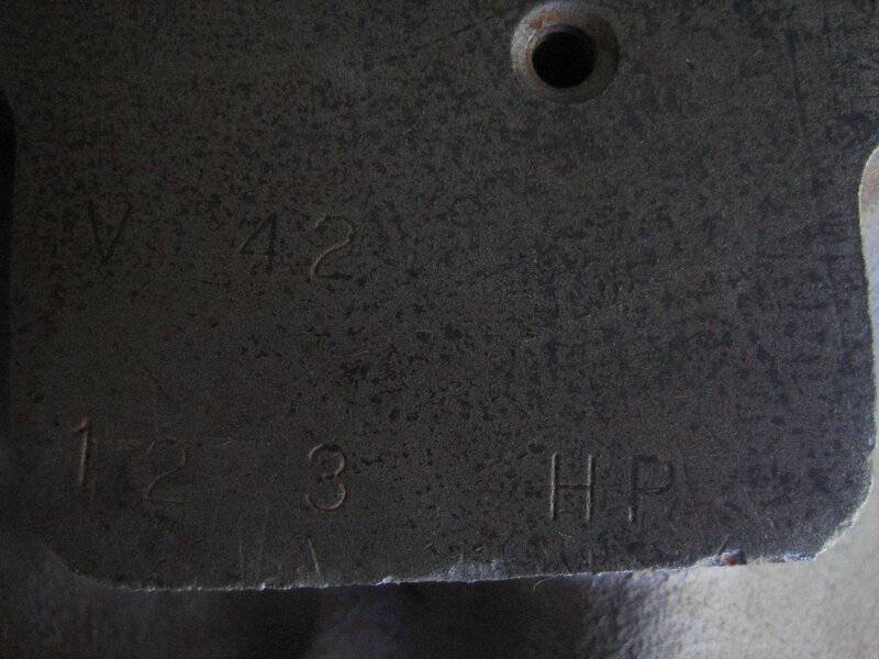

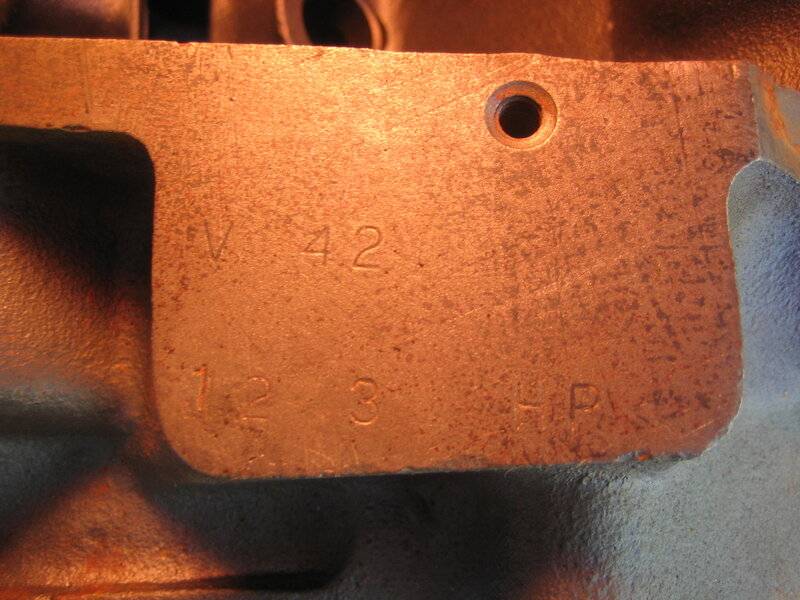

Here's a street wedge I used to have. These are all the same block with different lighting to show the stampings.
