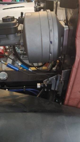

My brake system is a custom bend and build.
4 wheel disc. I installed the proportioning
valve up by the master cylinder. It makes
adjusting the system much easier. If you
we're to do this it would require a straight
thru adapter/connector where your valve
is now. I'm getting old, and crawling
around on the concrete is not really
something I look forward to.
Careful with the valve your planning to
install. Brake fluid will eat that adjustment
knob. (note the aluminum one on mine!)

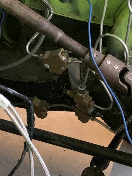

I'm using the original set-up on my 72 with power disc/drum. It works great.
No need to overthink or over-do it in my opinion.
Chrysler spent more on research them we will ever see to design a system that works and complied to about every idiot thing the consumer could do. So why mess with it unless you are planning on modifications to the system?
I use the original system used after 1-1–1970 with metering valve. Works great.
