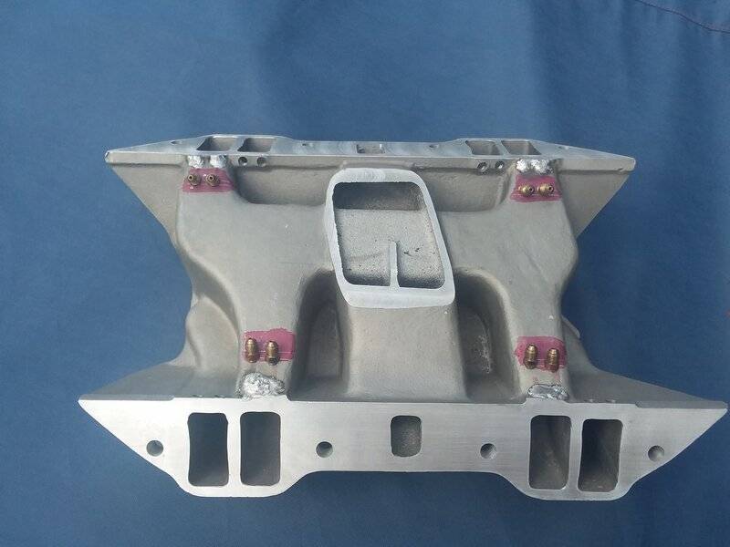

I'm building a 505 RB stroker. Indy EZ1 heads, hydraulic roller cam. I currently have an Edelbrock RPM intake. 64 Sport Fury. This is mostly a street driven car.
I have the valley plate from Indy. It won't fit with the RPM intake. The heat crossover is in the way. My choices are to have the crossover milled off the intake, or get a 440 source valley pan with the drop down in the cover to clear the heat crossover, or use an eddy Torker2 intake, or maybe the Holley streetmaster, Chosen for hood clearance.
What would you do?

I use the stamped valley pan but I did mill my heat crossover off. Aluminum heads w no heat port, less heat soak into intake from being close to engine and more room to run wires from my fuel injection. Actually just used an angle grinder to cut it off, pretty easy. Since you already have the Indy plate and the RPM manifold, at home angle grinder is my vote.
If the heads do not have a heat cross over than cut it off and use what you have. I see you live in Florida so very little to no benefit to a crossover especially true if you are running headers.
If the original plan was to use the RPM intake, then just cut the x-over off and use it.

If I had the EZ-1 heads (which have the Max Wedge port openings) and 4.250" stroke, I'd use an Indy Dual Plane or single plane. Getting a Max Wedge port opening out of an RPM intake must be done with care (same with the Torker II).
A well ported RPM intake would handle a street 505 and would be capable of 640 HP before 6,000 rpm. Seen it on a 4.150 stroke 496. The Torker II was down about 20 TQ and 20 HP.

I'm thinking you meant the Holley Street Dominator and not the Streetbastard made by Edelbrock? You do NOT want to use a Streetmaster but I think you probably know that.
What he said. With max wedge port openings, you really need an Indy intake. Or perhaps a cross ram…

Thanks for the input. I have the ez325, which is standard port. Sorry for any confusion. Also, I guess I am going with the RPM.
