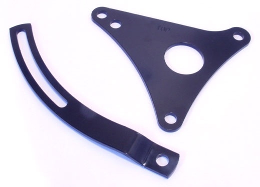

It looks like you have a bracket for a 383. Places like 440source sell what you are looking. By the way, the lower bracket goes on the other side of the big bracket.

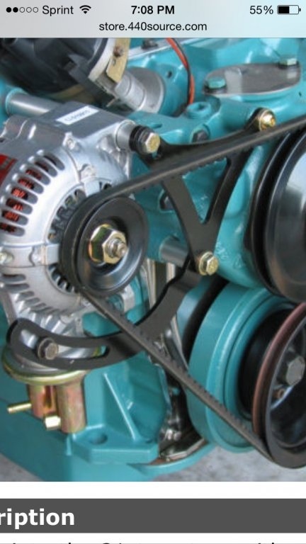

Ah, but these are those brackets. From the 440source site:
I've got the triangular one turned the right way, don't I?
Oh, by the way, I just noticed it in my own pic - top pivot bolt is loose.:BangHead:
Fixed now.
My bad on the wrong bracket. You have a bracket that is for both a 440 and 383. The side by side holes determine that. The bracket that I was referring to is the narrow one. It mounts behind the triangular one.

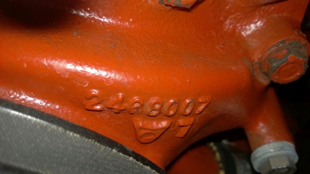

UPDATE... You have a waterpump that is to old for that bracket. Notice the area by the neck mounting bolt location. image.jpg
Ok, so apparently this '75 block has a '66-back water pump housing on it.
Go figure...:wtf:
I guess that means I either have to change out the water pump housing or find an alternator bracket for a 64-66?
If so, I reckon I'll try finding the bracket first.
Thanks much for the help!:thankyou:

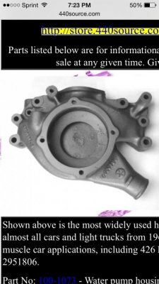

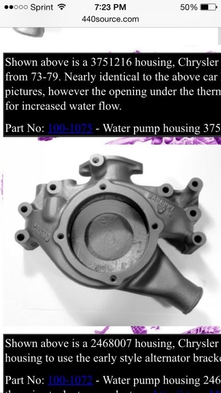

That's pretty much what I got out of it too. The water pump housing pics are from 440source. On there sight they have a pretty good right up on the years as well. Also the bracket specifies 68 and up.

Mystery officially solved. I do indeed have a water pump housing for the 64-66 big block engines (including hemi, apparently):
That means all these wonderful alternator brackets I'm using now (as purchased new from Rick Ehrenberg, no less) are wrong - they're for the more usual "newer" big blocks up thru '74.
What I DO need are these:
They fit all the '64-'66 big block cars without a/c.
Anyone got these they'd be willing to sell?
Yes, I'd be willing to swap as well for what I have now.
