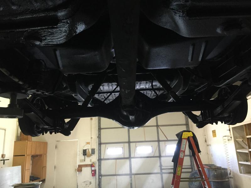

extra 1/2 leaf on the bottom ..is that normal or is it to add stiffness or height ??
If my recollections are recolated right, that is normal on Hi Performance cars from Mopar.
Nope, not that kind of add a leaf is from the factory.....
JC Whitney add a spring height helpers... Not stock!
I can't see the pic very well but my 68 GTX had an extra half leaf on one side from the factory. Then I bought the add a leaf set from Summit for an extra 2 inches of height to fit my tires
HA !
With as many Dodges and Plymouths that had these waaaay long ago, you'd think they were a factory thing. They were not.
JC Whitney, Pep Boys, Auto Zone....These cheapie booster/helper springs were often found on the shelves of these stores for years. Please remove them and give them to a Ford guy.
