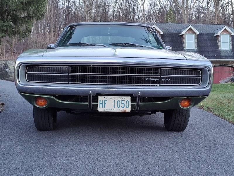

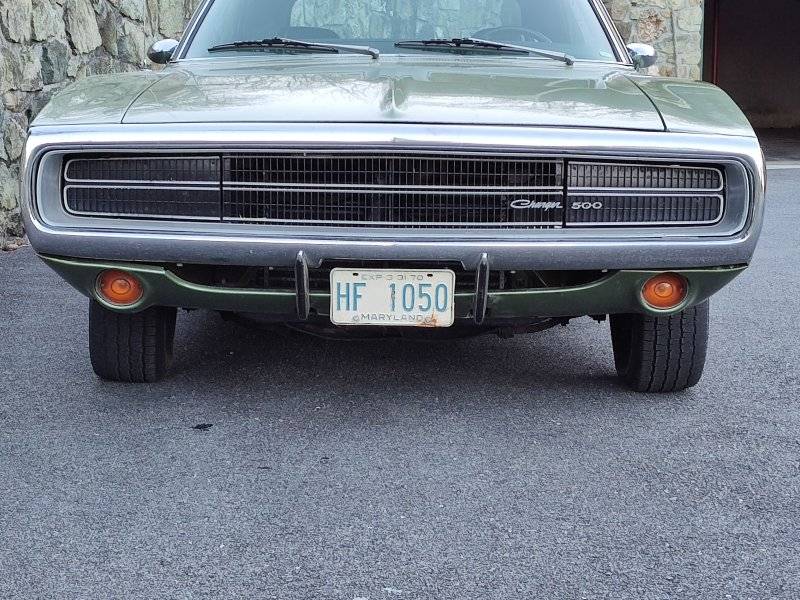

Rebuilt the front end. All new bushings, all new ball joints. New adjustable strut rods. I drive backwards and I get this:
I drive forward and I get this:
WTH did I get wrong? No popping, no creaking, no steering wheel jumping...just a massive camber change.

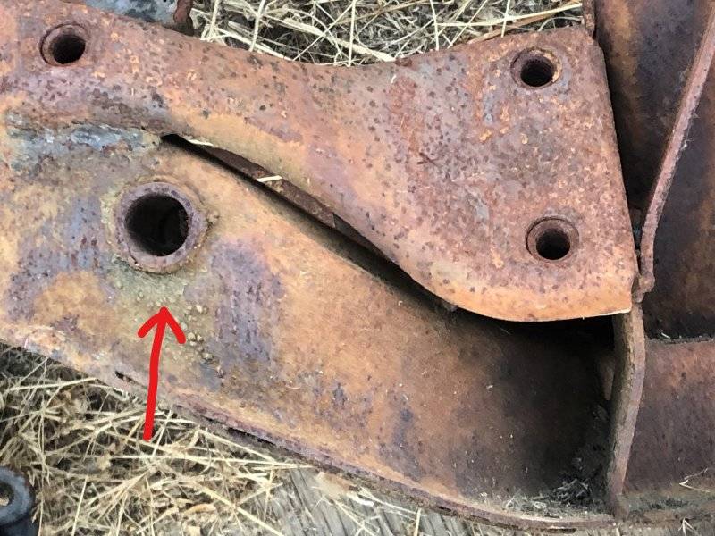

I have had this happen when THIS area is egged out:

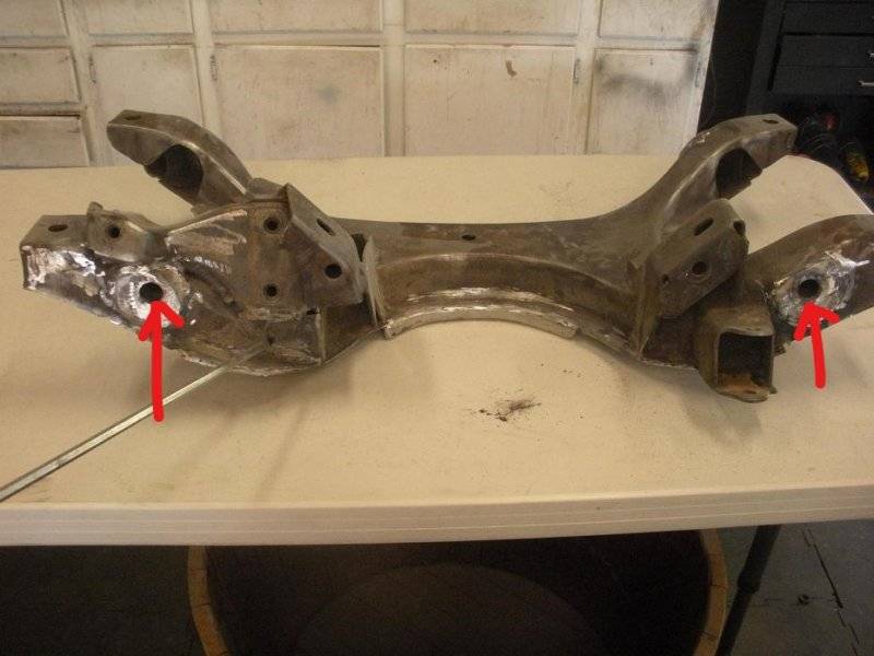

That is where the LCA stud/pin attached to the K member. I weld washers over the K members when I have them out of the car.

Toe won't change that much without something moving. Noise or no noise there is some serious movement of a component(s). Look at the two pictures. The top picture the camber is negative. In the bottom picture the camber is posistive.
