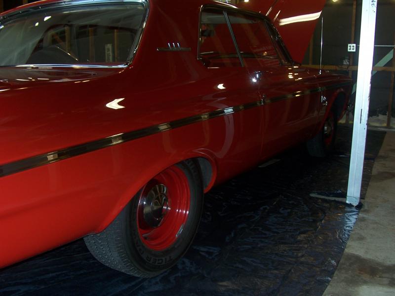

I have finished rebuilding the front end on my 65 belvedere, painted under the hood and yesterday got my 440 under the hood. Now it is time to concentrate on the rear of the car. My original 318 car has shot springs and wanted to find new ones that would be good for a street car. I have heard that I don't need super stock springs as this car will be mostly driven on the street. Also, I don't want this car to be too high in the back. I would like it to sit level. Just my personal preference. I have read that I can use a body springs? The car has all stock suspension otherwise. Any advice is greatly appreciated. Thanks all!

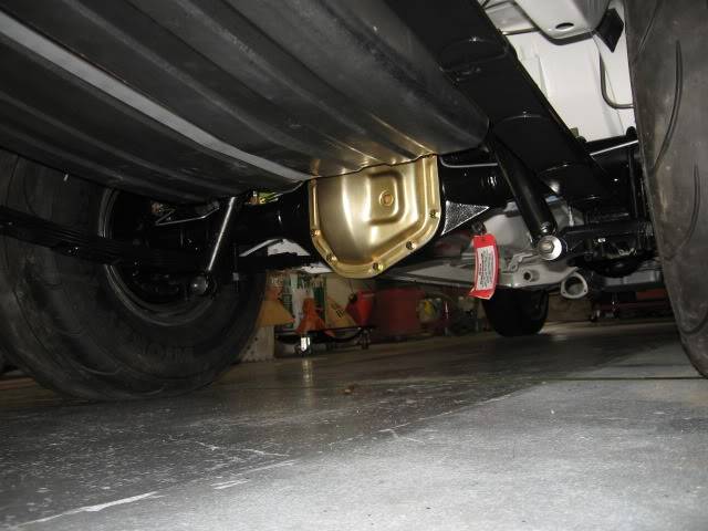

I used the #456 and #457 SS Springs. 3,400 lbs.
Work perfect and the ride is not bad at all!
It settled after about a year and does not sit high at all.

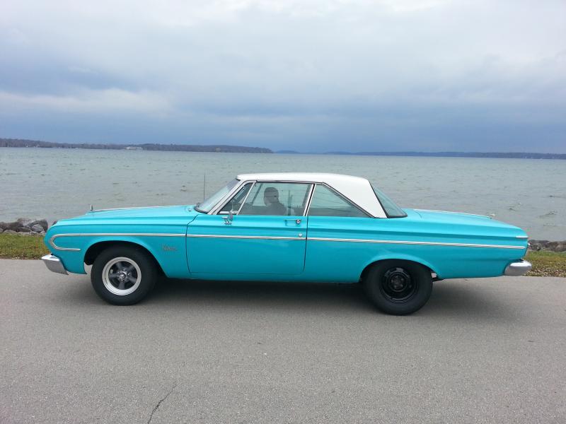

I have 3400lb SS Springs on mine. I don't think it's too high at all, and the ride isn't bad, either.

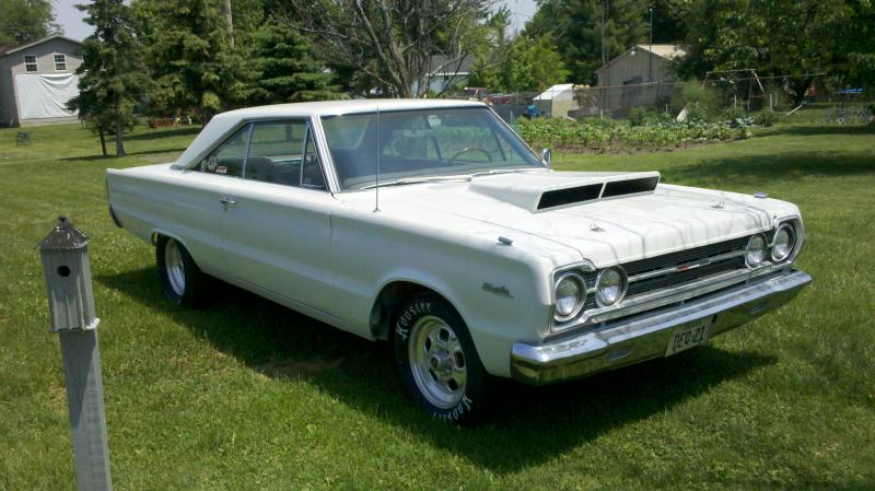

I have the 3400# SS springs on the Belvedere. Not certain about ride quality since it has not left the garage yet.
