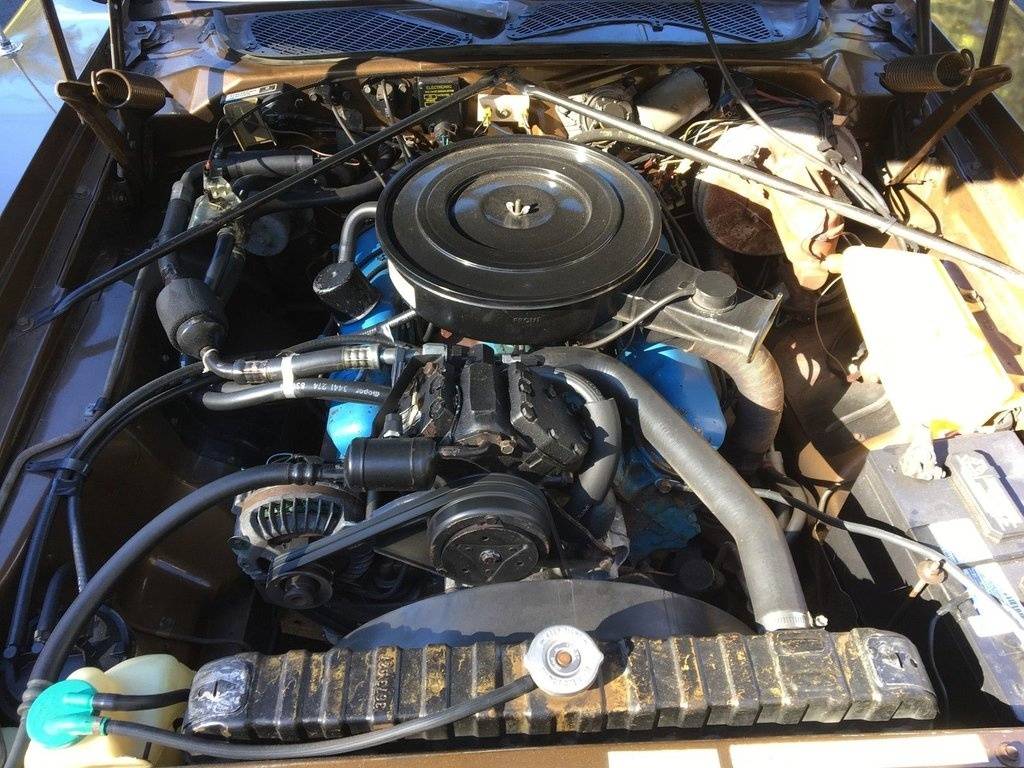

I've gone around the horn, from a 408 stroker to a built 360 to a stock 340 and back to the 408. A hard look in the mirror says a $$ engine build doesn't have the value for me. I've had my fun with two HP 440s, I'm gonna dial it way back and...go the poor man's route on the 318 in the car. Objective: smooth idler with some balls between 2,000-4,500rpm. A cruiser, pure and simple. And it has to look as factory as possible. Here's the plan:
Car: the '73 SSP in my signature
Weight: about 3,600lbs
Rear differential and gears: SG, 8.25", 3.55:1
Tires: 205/60R15, or 215, I don't recall
Transmission: 904, stock TQ
Accessories: AC, power brakes
Engine: LA 318, 81k miles
Heads: stock
Bottom end: stock
Intake: either Edelbrock LD4B or Edelbrock Performer 318/360
Exhaust: 340 HP manifolds, duals
Carb: Carter AVS 4640SA
Cam choice: since I'm doing nothing to the heads, I'm thinking either the Hughes 318 Whiplash or a stock 340 grind. Don't wanna kill any low-end with a large cam. I want the AVS 'cuz a vacuum secondary will only give the engine what it needs and its on my shelf. I have the 340 HP manifolds already. Dual exhaust is on it.
Do I need to replace the springs if I keep the lift around 270?
No need to tell me I should get 340 heads with bigger valves, I'm not putting that $1,000 into it. I know the heads are the weak link here.
Thoughts on the cam? How do you think the combination will perform? I'm not trying to recapture BB glory, but I think these mods will wake up the 318. Thanks.

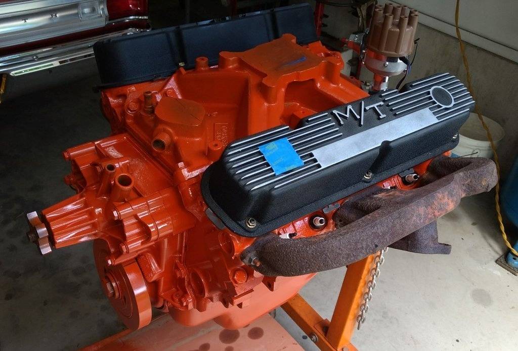

myself. A deal came by me yesterday that was too good to pass: in my budget and my area of operation. I apologize for this wild goose chase. But here it is:
1972 340 block
Steel crank 0.010/0.010" U/S
Crank accepts A.T. or 4-speed, NOS pilot bushing installed
0.030" O/S 10.5:1 forged pistons, floating pins
File-fit moly rings
Internally dynamically balanced
Resized forged rods w/ MP bolts/nuts
Tri-Metal bearings
Original heads - induction hardened exhaust seats - 2.02/1.60 valves - professionally bowl-ported
MP Purple stripe hydraulic cam & springs
Fel-Pro gaskets throughout
Edelbrock Torker intake - no hood clearance issues
New "cop" big-bearing water pump
New 340 fuel pump
New Mopar distributor, NOS tan alkyd cap
New stock oil pan, original crank scraper ("windage tray")
New oil pump, drive gear, and bushing
Stock damper
M/T super beefy cast valve covers
New cr-moly pushrods, mint stock rockers
Just needs my carb, my exh manifolds and my accessories. Bye bye low-end torque, hello heavy-breathing, high-winding SB.
Thinking to swap out the Torker for an Edel LD340 or similar dual-plane low rise intake.
