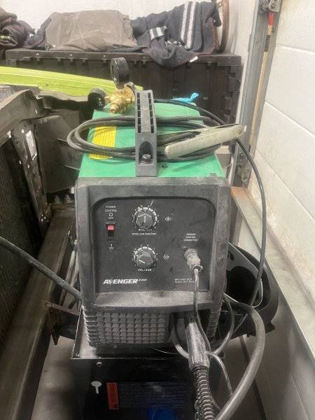

Here is a picture of what you use FCAW for. This is what its intended purpose is.This little avenger 140 is the best out of all the small machines I tested . In the welding trade we call FCAW the icing. It just lays on top. I have watched that **** break and snap for no apparent reason. I won’t weld with it in certain situations especially if I want to count. SMAW go hot or home!
