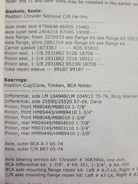

Clutch type LSD 1-11/16" on the carrier and 489 case 3-1/4" OD on the race.
The bearings and races have part numbers etched on them...
Call a parts store and get part numbers for a 742 axle, or you can look it up on rock auto and get part numbers there...
There's 2 carrier bearings. Clutch type/ cone type
clutch type sure grip carrier bearings 25590 cone 25520 race Timken , National etc.
