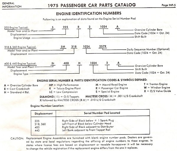

Hi, Iam new today,,, what do i have,, here is what i know it is a 440.. block pad reads 6T 440 E under that is 4 5 - and the head is 4006457. block casting is 4006630 440-2.date 2 12 76. and??? would a 1965 383 commando have more hp. than this 440??? Thank You emile ps the front pully has the dome style weight.
...what do i have? I know it is a 440.. block pad reads 6T 440 E under that is 4 5. The head is a 4006457 casting. The block casting is 4006630 440-2.date 2 12 76.
This is from the 1975 parts book but the same information applies to a 1976 model year block. The block was cast on February 12, 1976. Is there a VIN number on a pad on the passenger's side?
