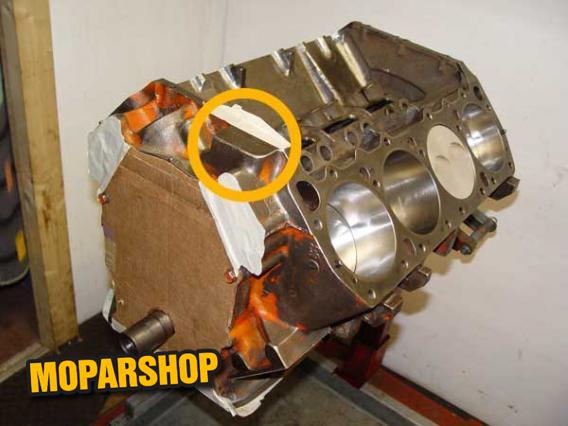

Does the distributor hold down go against a block of metal or a rib of metal? If its a block its an RB and the engine size will be stamped on it. If its a rib its a B and the engine size will be stamped on a flat area under the distributor.
If its a 413, 426 or 440 it will have this block. If not its a 361 or 383 or maybe a 400.

If its an RB the displacement is stamped right on that block. You might have to scrape some paint off to read it but it should be there.

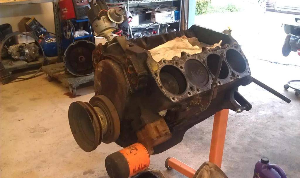

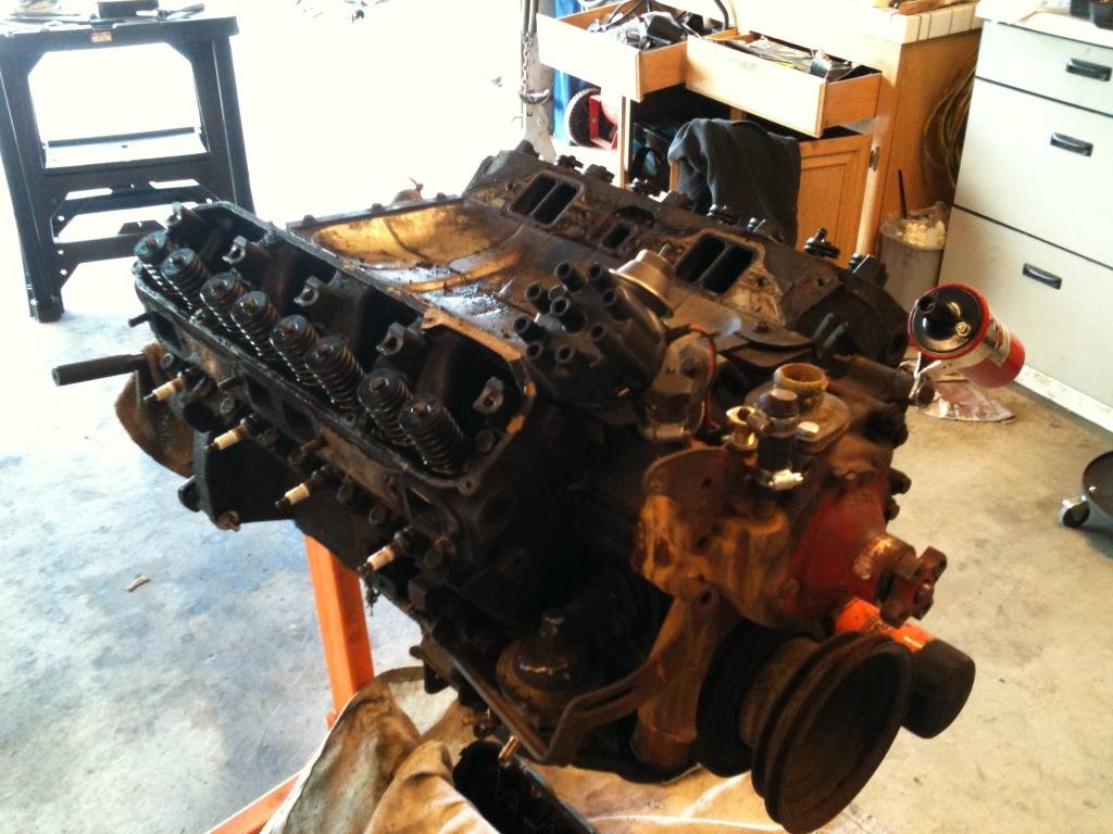

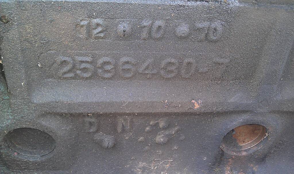

So today i pulled the Engine and trans, and the number on the block is, 2536430-7! so anyone know what it is i have here?? heres a quick pic!!

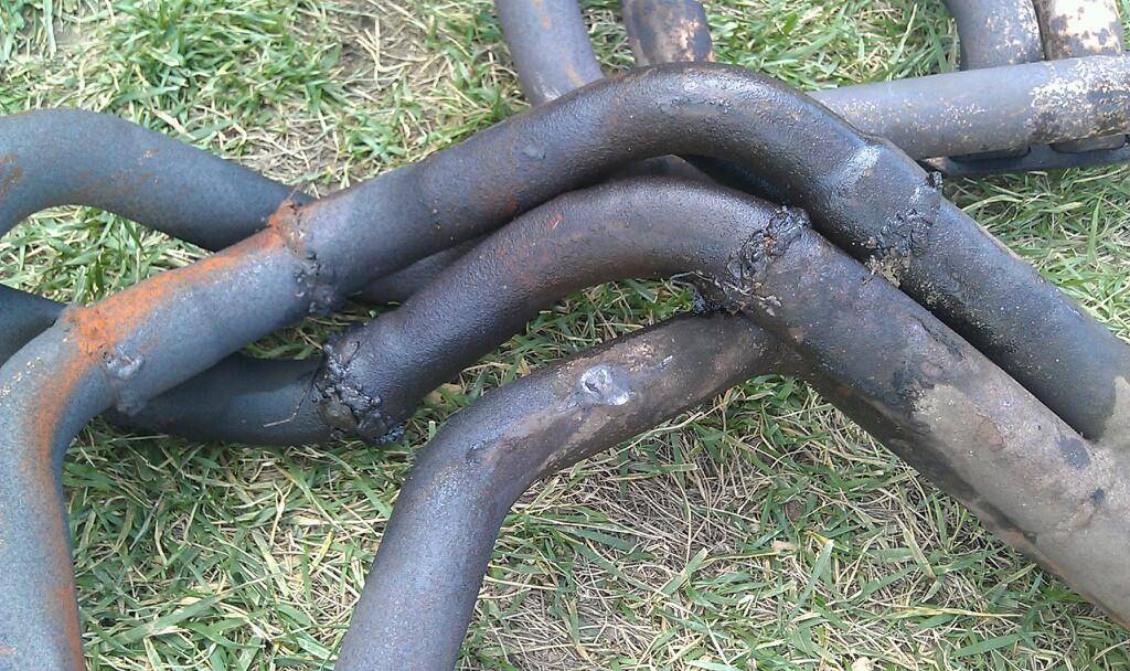

And another Question, anyone know where i can find some afordable headers for this 1966 Belvedere?? Dont think these r gonna cut it!! lol
it's a 440- 1966-1972 based on the casting...
It's a late '70 casting 440, probably came out of a '71 model year car. If that #3 piston is at TDC it's a low compression (8:1) engine.
