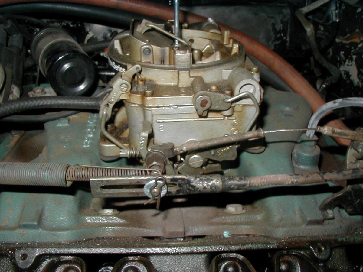

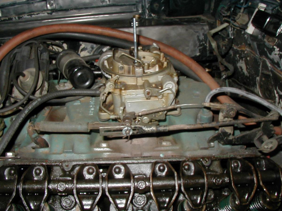

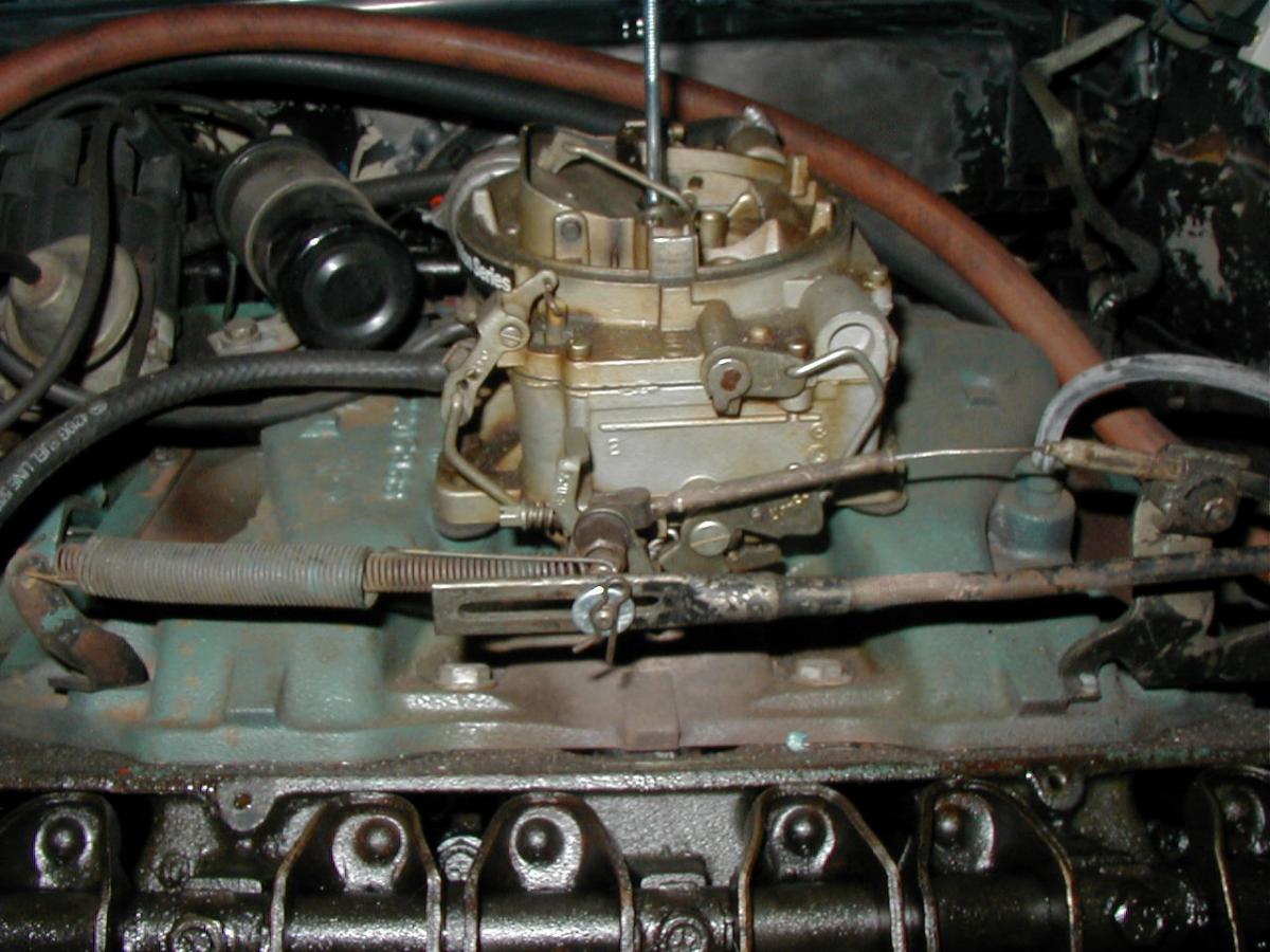

Here are a few photos of my linkage....please excuse the crappy looking engine, valve covers are being bead blasted prior to the rebuild. I have no other linkage to compare what I have with.

kickdown linkage
if that slotted end is'nt threaded onto the rod (for adjustment) , might be a good idea to go back to the "bolt trick" until the new setup is in place, then modify linkage- might be alot closer to being "right" with new stuff. as cranky said, it shouldbegin to move when throttle moves & all the way back at wot. almost a 1-1 ratio
With that setup, it looks like the throttle will move a good half inch or so before the kickdown rod moves and that's not right. It's also supposed to have a return spring on it too....
