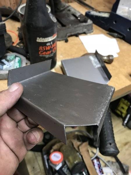

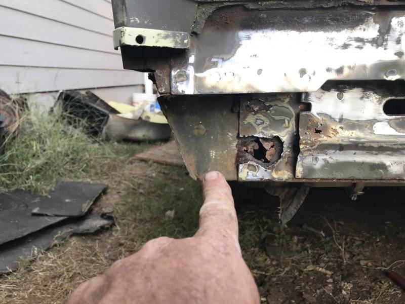

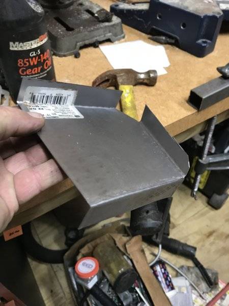

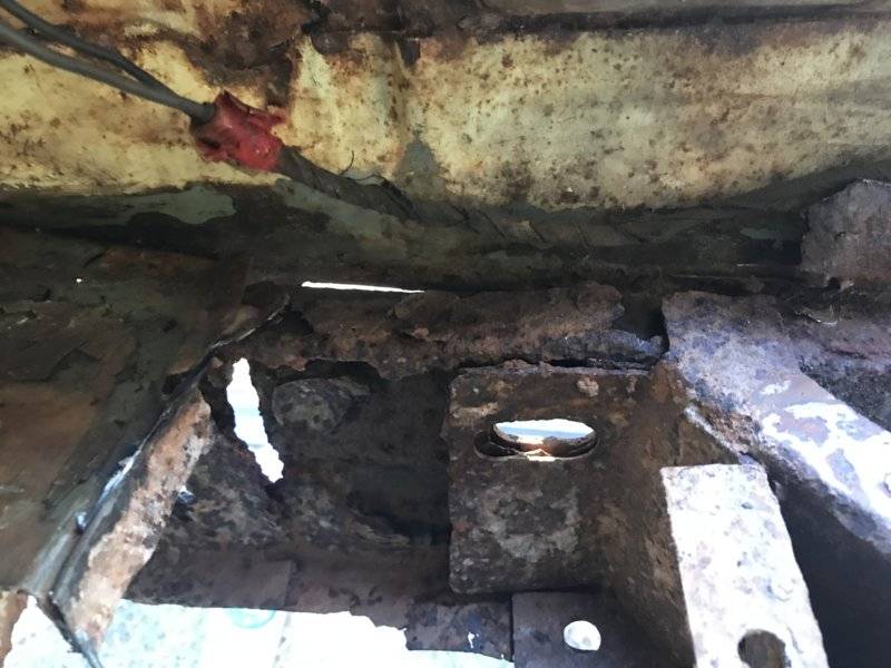

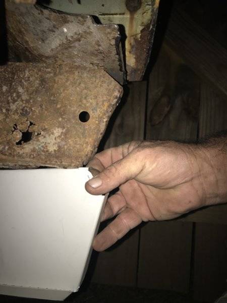

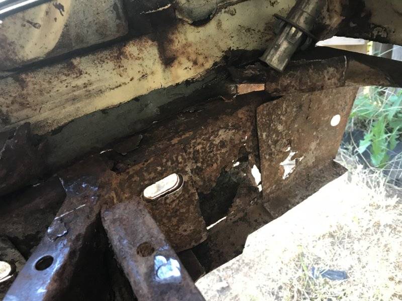

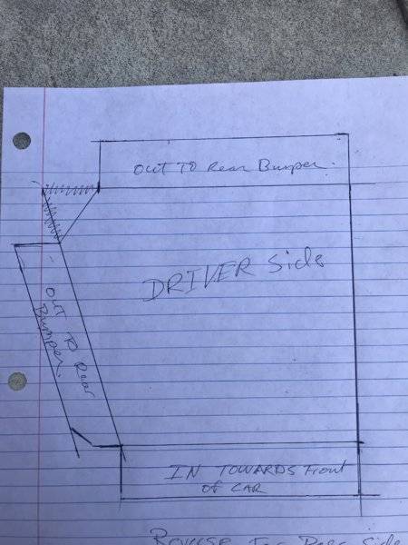

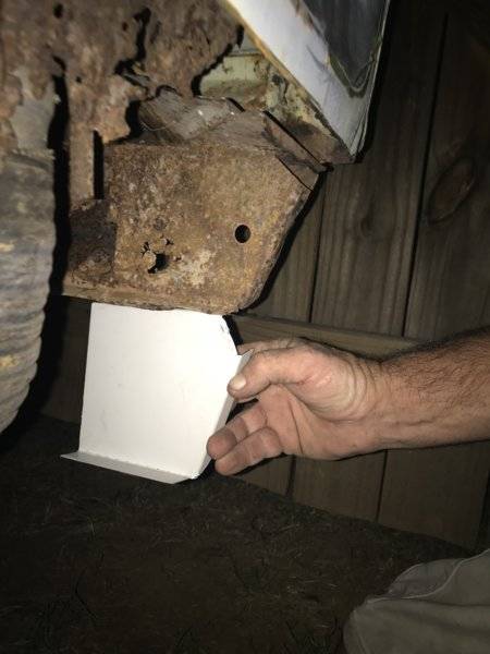

Well more cutting today but also started to draw out what I need to make out of sheet metal. These will tie the rear panel to the trunk extension. Then I have to make some pieces around 20 inches long to fix what is rusted out one either side of the car. Just flip it for the passenger side. Easy enough But the piece you see with the rust hole to the right of my finger will be 20 inches long and tie back into good metal. Then there is the Bumper backer.. or stiffener.. That's pretty thick and not sure if I can make that center bulge other than that it doesn't look terribly difficult.

Nice work! That rolled hump is what keeps the bumper bracket from sliding off. I would carve out a trough in a block of hardwood the same size plus a little bit, and then hammer the metal down into it to make that hump. Use something rounded like another hardwood block to hammer on, that will keep from heating up the metal and stretching it to much by slamming it with steel. Clamp down all around the place where you will be hammering so it stays flat.

Beautiful handiwork. Yes, 66/7 stuff is hard to come by. There is some, but not much. If you keep up with that type of fabrication, you will have all the inner structure wrapped up nicely. Then you just have to deal with the lower quality quarter patches available out there. They aren't the best, but they are better than nothing.
