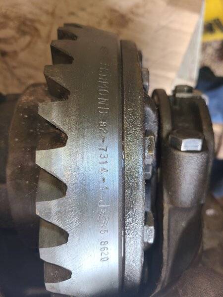

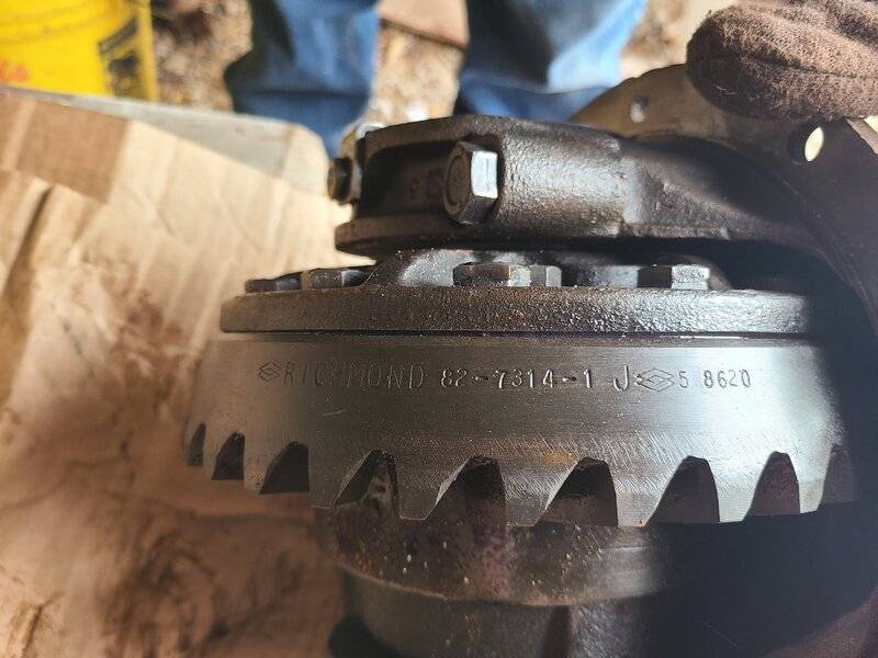

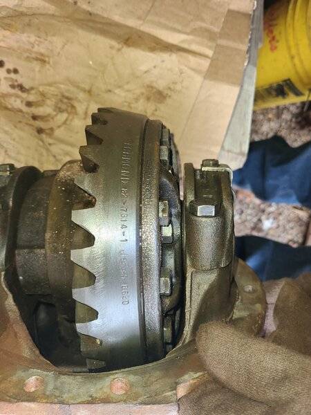

What gear ratio is this, this is all it has on it
Nothing comes up under 82-7314-1 on the Richmond site.
Richmond gear
82-7314-1 (closest I could find was 82-7315-1 is 4.56:1 489 case 8.75")
steel 8620
Well, you can count the teeth on the pinion and ring gear and divide it out. Mark the starting point and just go slow. Not too hard to count the pinion teeth if you go slow with it....but it sure looks like a 4.56
