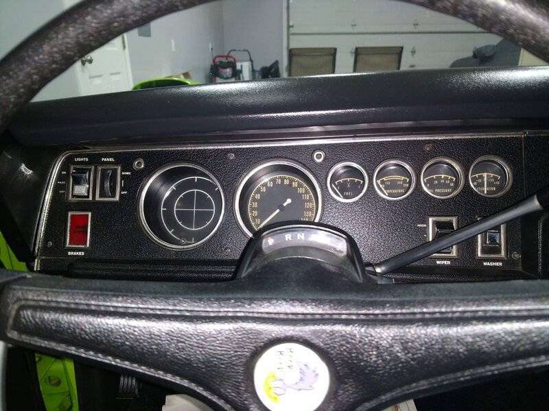

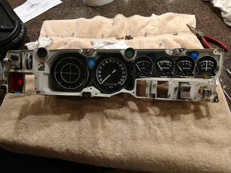

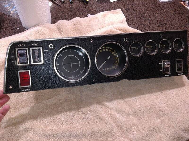

So you don't see the white housing around the gauges? 69-70
I'm not sure what you are seeing:
IMG_20181223_173415136.jpg IMG_20181223_163132902.jpg IMG_20181223_154047876.jpg IMG_20181223_132710276.jpg

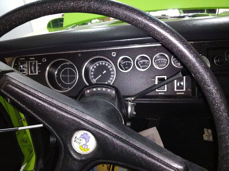

Oops...the last picture was a "before" picture. It should be:

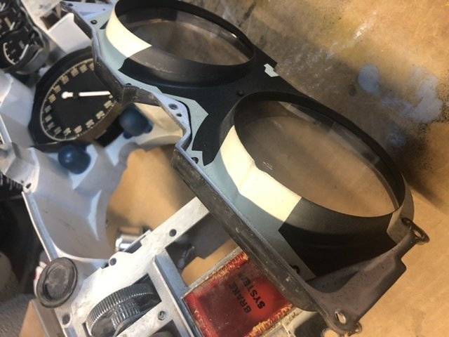

I can see the white housing around the gauges. The cluster I picked up was missing the lense so I got an after market one. when I put the bezel on the blue light sockets and white housing are still visible. I can post a Pic if it would help. I'm guessing there is a shield that goes behind the lens that blocks the housing out of sight.
Your lens should have "blackout" printed on it. If it doesn't, it's not an accurate reproduction because the factory lens has this.
post a pic please
A member on my moparts thread posted a picture of a metal piece that is fitted to the back of the lens that I need.
