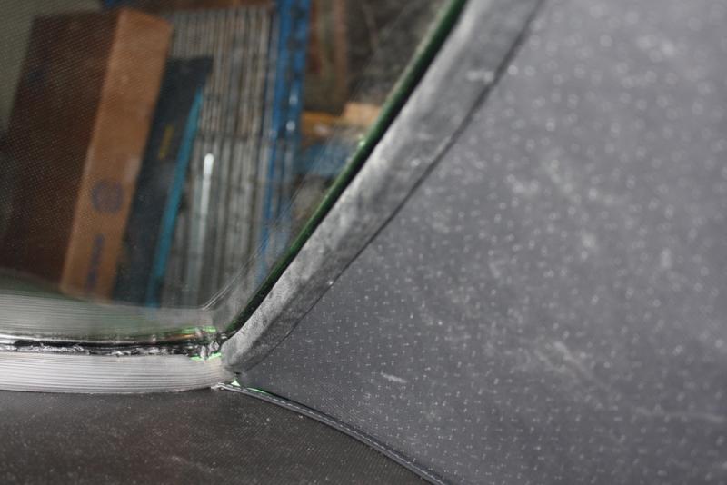

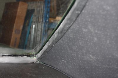

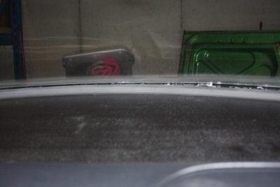

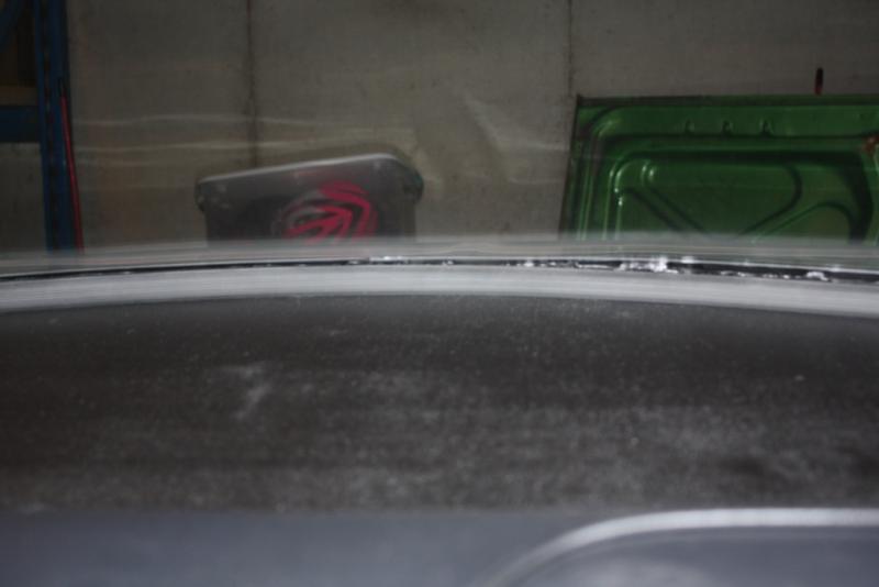

What fills in this gap at the back of the parcel shelf and below the rear glass ? Photo be great
Thanks, Tony
There is a trim piece that slides over the back edge of the package tray before you install it. I don't have a cross section shot, but installed pictures are attached. I hope this helps.
D
Perfect photo Big D A12, don't have that piece of trim so will make do with something. Helpful photo as I can see how the rear sail panel fits too.
Thanks Tony
Whoo ! Just found it in the shed. Knew what to look for.
Glad to help. About the sail pillar panels. If you are using reproductions, don't be afraid to modify them. I ended up moving the anchor points on the back along with trimming the panel itself so it aligned properly.
