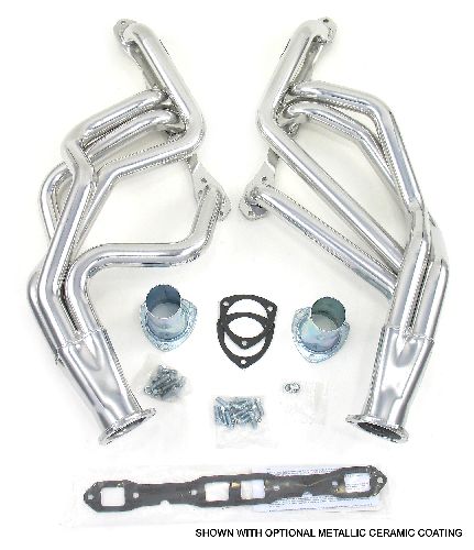

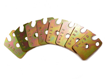

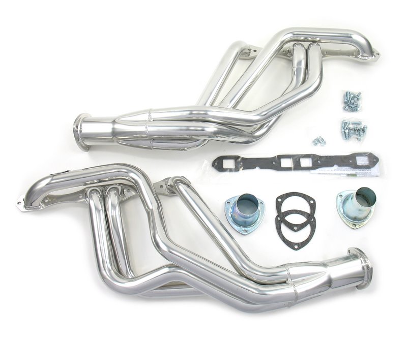

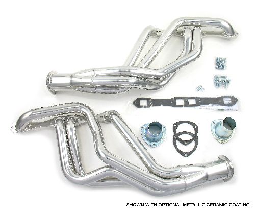

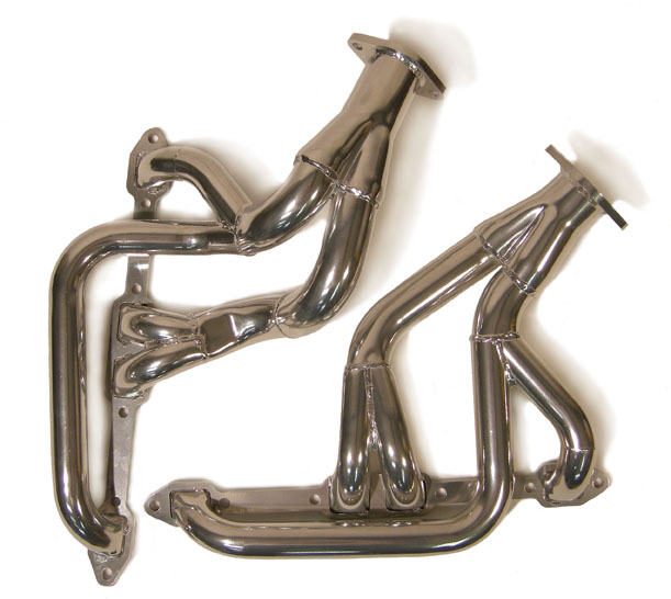

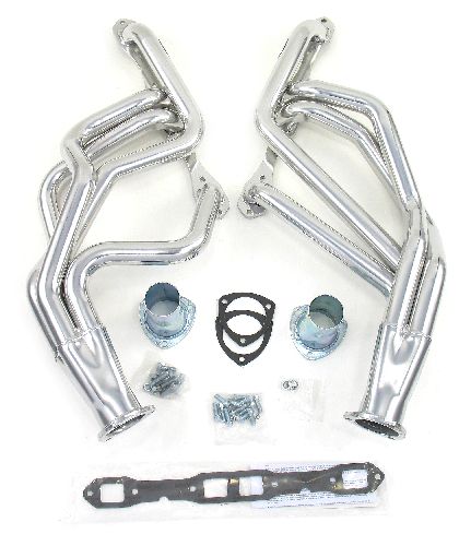

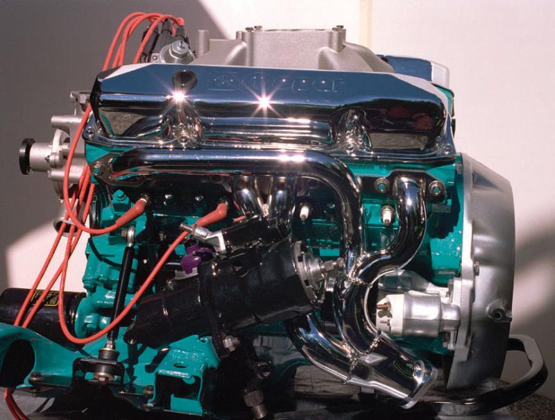

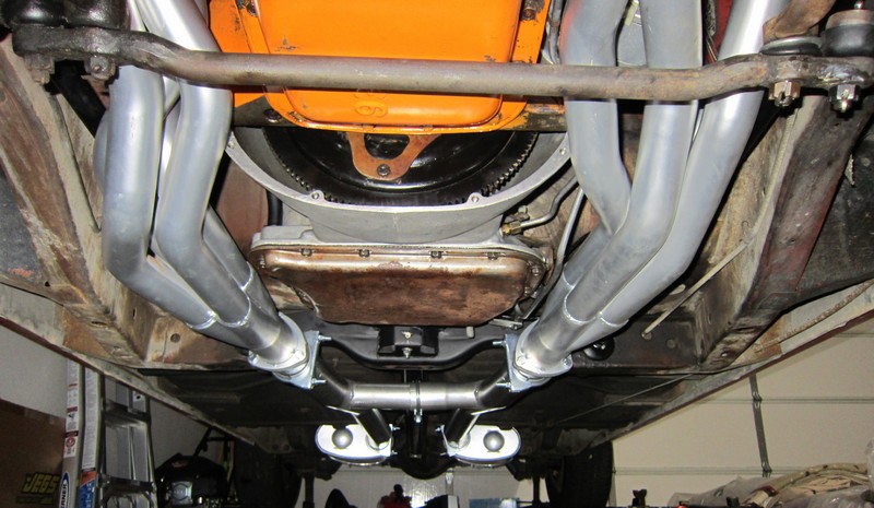

How large of tubes do you need ?? 1-3/4" or 1-7/8" or 2" ?? do you want bolt type in mas produced ??, coated or not/raw ??, what kind/size of starter &/or flywheel ??, what kind of oil pan ??, what kind of steering & box ??, what kind of trans & shifter, column or floor ??, do you want low end torque or high RPM's ??, all can make a big difference in the fit & whos headers can or will work... For fit, TTI or Dougs or Schumacher Creative Services stepped, tri-y's & Mopar specific, others cheaper types Doug Thorley, Flowtech, Schoenfeld {maybe not sure}, Hedman long tube or shorty, maybe a different set & style of Hookers, Gibson {maybe not sure}, Summit or Jegs house brands {maybe}, better brands are in bold... For real racing headers & components, look for merge collectors, 4-2-1 collectors, stepped headers, they aren't cheap, but can be made to fit your exact needs, car &/or engine, from top to bottom ,Dougs 383raw -440coated -440raw -440coated, under side fit TTI's 1-7/8"'s on a 68 -69 Charger 440, Schumacher Tri-y pass side -SCS tri-y's -SCS drivers side, SCS motor mount shims....
