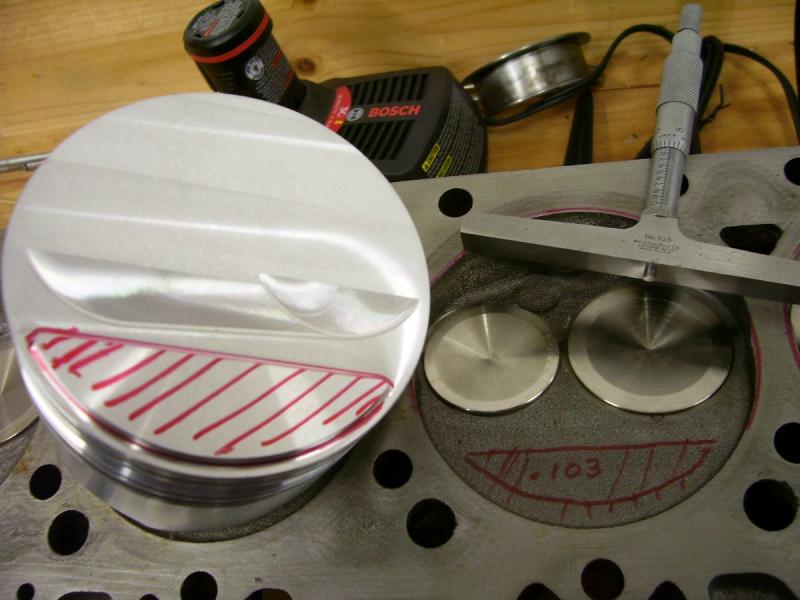

See if you can get the part number on the pistons. Reverse quench domes have a small flat raised area that goes up into the flat receded area of the cyl head. This comes close to the head and provides turbulence and quench when the piston moves close to the head. You want this clearance to be around .040". I have run .035" clearance with no probs

this is a pic of a quench dome kb piston and head. the outlined dome fits into the outlined part of the head. ideally you will shoot for a running clearance between .040"-.050" between the dome and the head. 100_0377.jpg

You can completely mill the quench pads/or domes as you all are calling them, right off and run the stealth or any closed chambered head.
Otherwise i'd do as lewtot184 shows, mill quench pads or heads to obtain the desired quench distance..but i'd shoot for .040 on the nose for quench distance if it were me.
