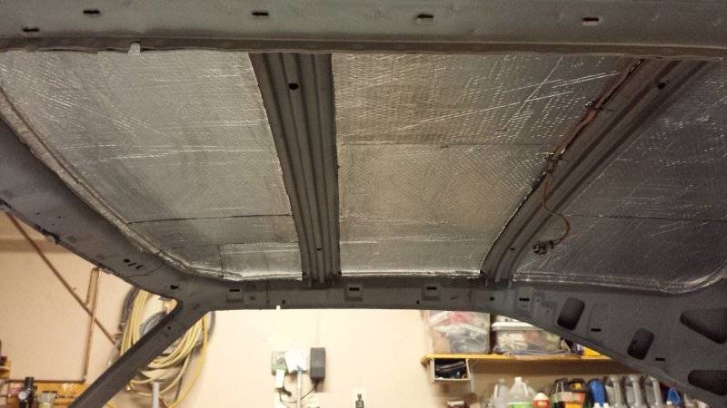

I used a stick on mat, Noico 80mil. Got it on Amazon. I just verified that is what I bought.
Rather than focus on the cheapest I chose a product that rejects heat... Only cool car I have with a solid roof is a station wagon... It's got a lot of roof & I prefer not to get cooked inside the car....

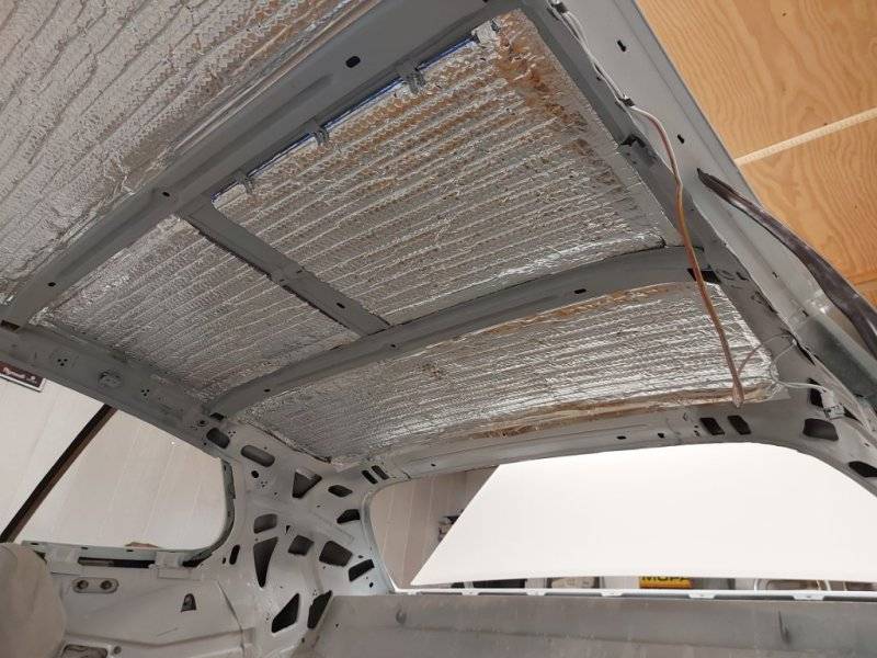

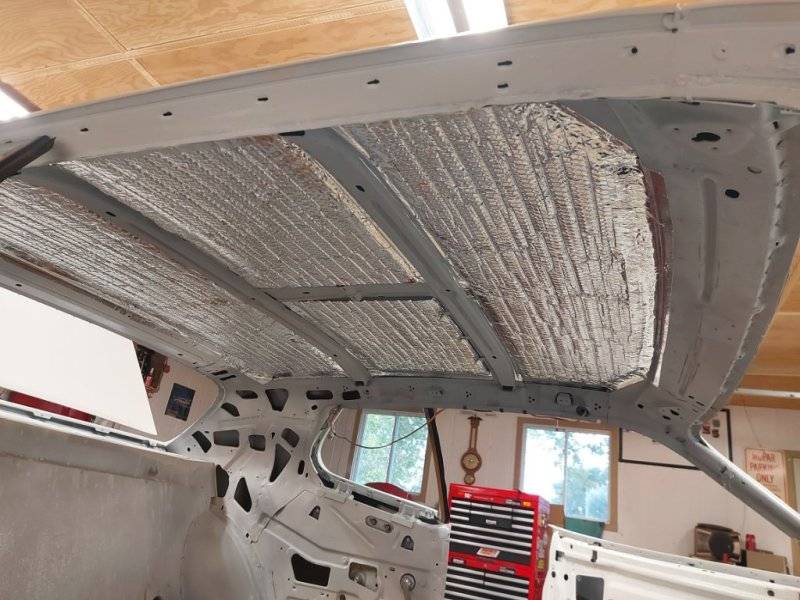

I used the bubble insulation with the foil on both sides sold at most home improvement stores.
Cleaned the steel , cut my pieces, hit the foil with some spray adhesive.
Stuck it up, seems to have worked just fine.
I used this stuff in the whole car. It’s for A/C ducts and what I like is that is has a reasonable medium tack. It’ll be removable.

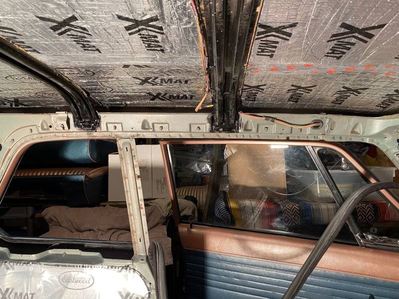

I used Eastwood heat and sound barrier XMAT Under Hood & Headliner.
Whatever you look at, if you use a product with adhesive already on it, make sure it will withstand being inverted. The manufacturer should be able to tell you that. The last thing you want is the insulation falling off.
