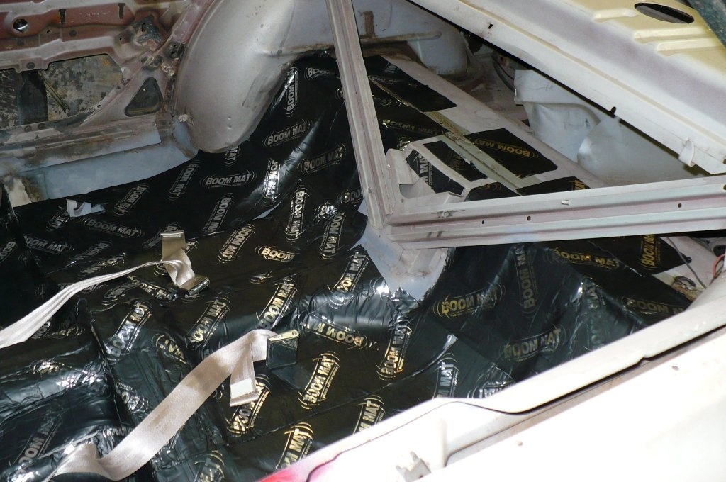

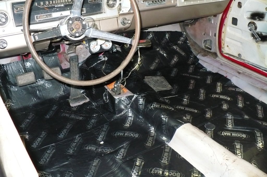

On this website seen bubble duct wrap aluminum backed applied with spray glue to firewall. Can buy at Home Depot. I used boom mat on floor of my Dodge. Didn't cover area on tunnel, want to cover flat surfaces first. Car's kind of noise, it helped well for dollars spent. There are similar products cheaper bt can't say I've used them.

where did you get boom mat? is it rubber based or something like that? Sout deadening ? Heat reflector?
Go to the "Foam Factory", and buy "Gym Mat". Comes in different thicknesses, and 3M spray-glue it to your surfaces. It's black, closed-cell foam. I use 1/8" in my cars. It's cheap.
The Boom Mat I bought on Ebay vendor uspartsoutlet in June 16. There vendor rating wasn't perfect but I had no problem. I searched a lot to find it at that price. B/M part 50210, 10 pieces 12x23 inches $89 bought 2 of them. There are foil with what I would say is sticky tar. They have plastic sheet you peel off and apply. Cut to shape first then peel. They say you don't need 100% coverage. Read up on it think they 50/60% coverage is good.
