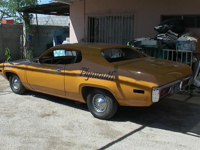

My understanding of a drip rail is that part of the roof above the side windows. I know I removed a chrome/stainless molding from there before painting my '72 SSP project car (and have not yet put it back on).
