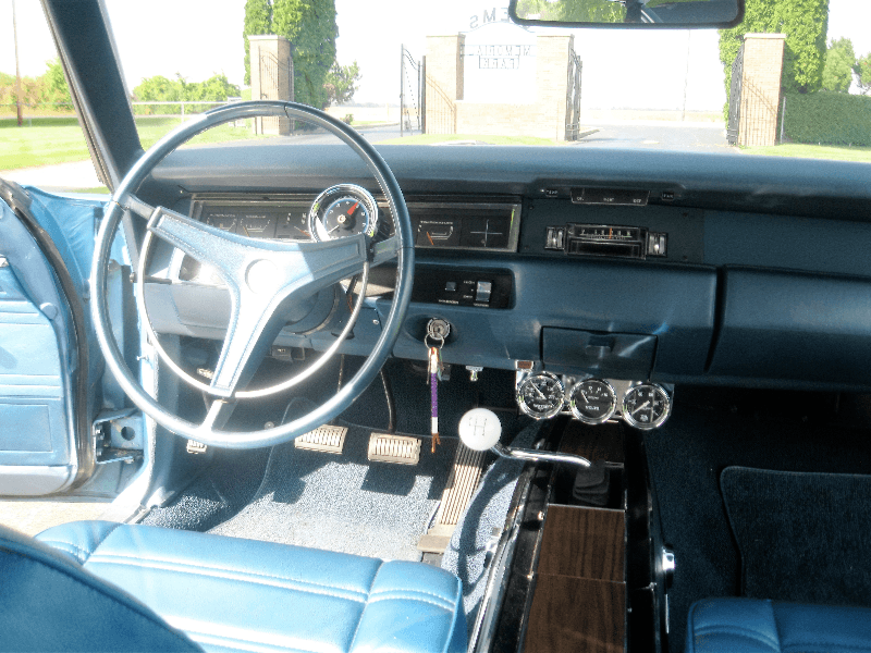

Mine has the 8 track. It doesn't show in the picture, but just below the numbers it say's "Chrysler Solid State"
Thanks, that's what I was looking for I think. I'm not sure if mine had the 8 track option but i have read if it's equipped with a 3 speaker dash it was an 8 track equipped car. Other than that i am not sure how to determine if it's just am radio or not.
What is on the fender tag? That should tell you.
Mine has a 3 speaker dash as well. I have 2 in the rear, but I'm pretty sure they where aftermarket installation.
If you do not have the 8 Track, you will have push buttons in place of the cartridge door. The 8 track is only AM. Not sure if an AM/FM was available, but simply look at the frequency scale. It's not easy to see, but if you look carefully at the picture I posted you can only see one (AM) frequency scale (same as below). An AM/FM would have a dual scale.

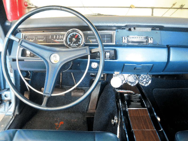

Here is one without an 8 track

Yeah, my fader control is blocked by the steering wheel in the post #4 picture.
It's visible (just above the shift knob) in this one, so the rear speakers must have been OEM. Probably came with the 8 track option.

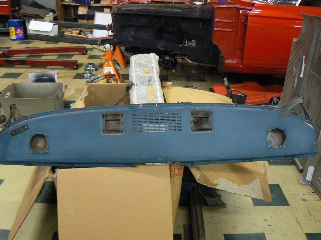

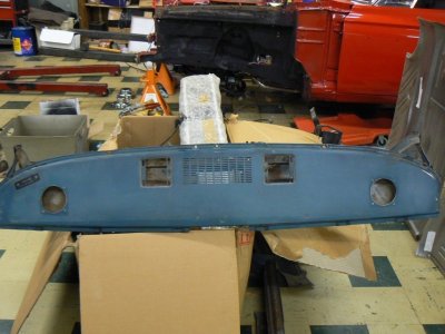

The two locations on the package tray look like they are for speakers, but one is for the rear window defogger option. The air intake comes through one of the "speaker" vents.

So you are saying that there is only one rear speaker and it is not centered, but off to one side?

Ranger & others. The metal under package tray was already punched out for 2 holes- 1 for spkr, 1 for defog. My '68 had neither option so the "cardboard" had no holes in it, metal tray did have holes.AM radio& 1 spkr centered in dash.
Also 1 hole was running with the body and other was perpendicular to body.
