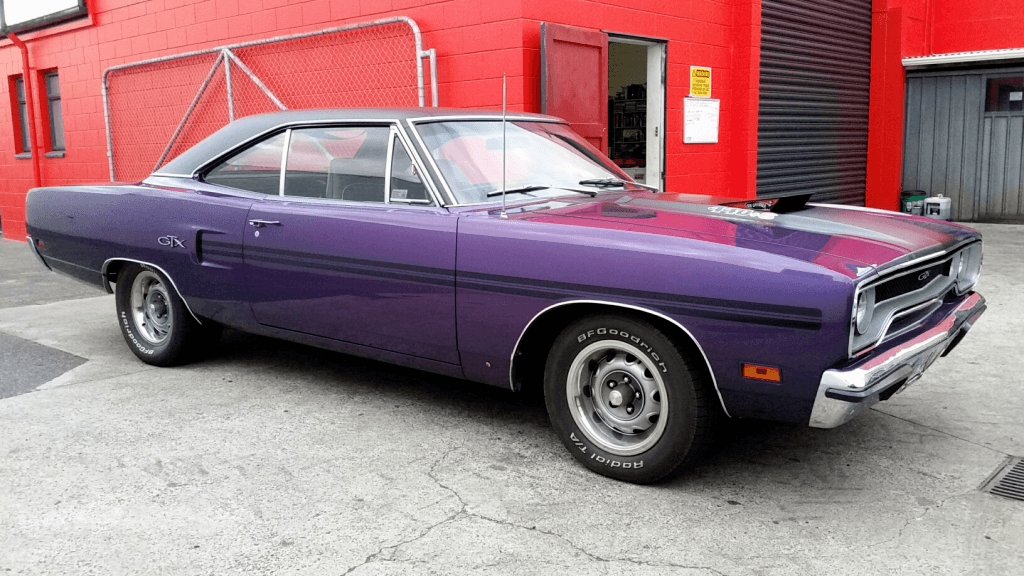

This pic of my GTX shows the 15" Rallye wheel with the chrome beauty rings
I am sure that the Magnum wheel (similar to Ford) did not have a beauty ring.

That's great I have the same wheel as yours picture do you know how wide the wheel is ?? Thank you I don't know what's on this car I have it the same wheel as the pic but has a chrome outer like a Ford magnum no beauty ring all chrome .
Probably not helpful to you, but mine are replacements at 15"x 8"

Looks kinda like a 6 1/2" trim-ring, on a 7" wheel.
Steel wheels had dog-dishes or full wheel covers. They were body color or black, depending on year. M-code 69's just had chrome lugs. I've seen T/A's with rings and dog dishes.
Rally wheels had different rings and centers, depending on size and year.
Road/Magnums were either chrome[early] or trim-ringed on later cars.
Magnums=no beauty ring. all chrome. Road wheels (Mopar's version of magnum)=beauty ring
what you and Kiwi have a Mopar rallye wheels. although I have never seen a Rallye wheel that doesnt have a beauty ring, but is chrome all the way around. interesting.
