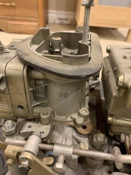

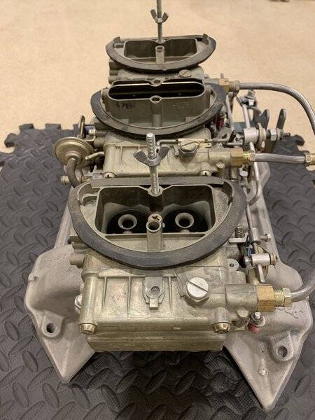

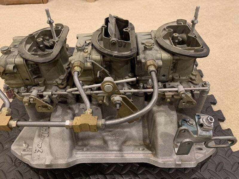

Have a chance to buy this but really don’t want to over pay. Mechanical secondary’s direct connection hussle stuff from the 70’s. What’s a real world value on this. Mint near NOS condition. Bought in the late 70’s and used for a very very short period. Will include air cleaner with NOS element from the 70’s too. They’ll need kits because of their age…. Outboards are 4782 and 4783 all on factory Edelbrock 440 intake…. Has the proper Edelbrock linkages too.

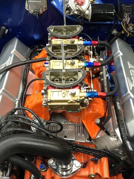

Well they are not all that rare to be honest (440 6 pack that is), it wasn't all that long ago that you could buy an entire setup new for like $2800, a friend of mine just sold a used set up that included the Air cleaner for $2500 ( might have been $2200).
That setup does have the fuel lines on the driver side so it will be a bit crowded there.
I believe that's a "six pack triple pumper". They've got accelerator pumps on all 3 carbuertors and no vacuum pods. Metering blocks too, with Ford side float fuel bowls for clearance. I haven't seen all that many.
Value is a tough call. They're not right for a numbers matching car. They're pretty cool for a performance upgrade (I've considered trying them). They would get HORRIBLE gas mileage. For drag racing, I'd say they'd be an improvement.
The triple pumper is truly awesome to drive, especially in a 4 speed. No waiting for the vac to reopen the secondaries after a shift (assuming you’re a person who lifts your right foot). The only carbs I can remember actually flooding a 440 with. These carbs are not common.
that set up is bad ***. you will get the same milage as a normal six pac unless you cant keep your foot out of it. only issue I had with mine was the air filter housing hit the needle adjustment nuts. super tune ability. Just like a double pumper with an extra set of barrels. stock sucks. As far as what to pay? who knows that kind of stuff is going for stupid money, if its as good as its said to be its worth good money. I had never seen those kinds of carbs ever then I had a set up. still have not seen any on a mopar.
I paid $800 just for the same carburetors a year ago. They are in nice shape but need rebuilt too.
I would think in that condition $1500 min. Just purchased a setup a lot worse than that for $900

that being said the carbs are 1000-1200 ball park. Intake 350 ish. Plus the linkage.
